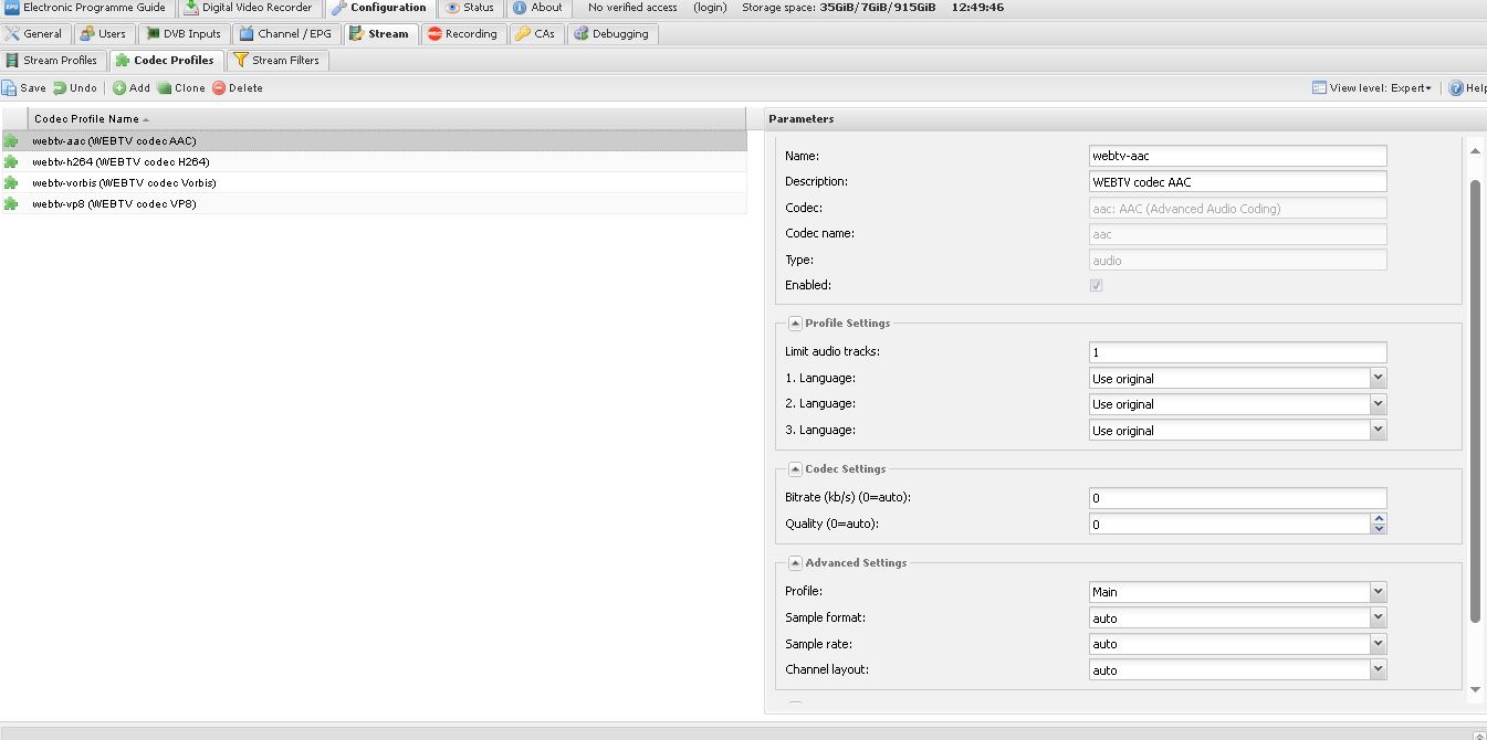

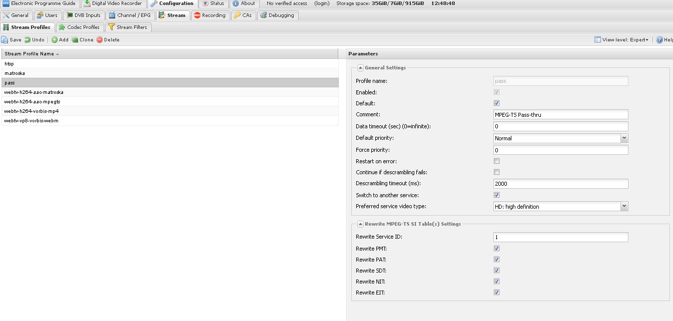

    I have attached photos of my current TVHeadend set up, in case it is relevant - do I perhaps need to make any changes here?

    Most if not all streams provided by TVHeadend plugin requires some sort of transcoding to work and if you don't have hardware acceleration it will cause high cpu usage. Can you check if that is really the case?
