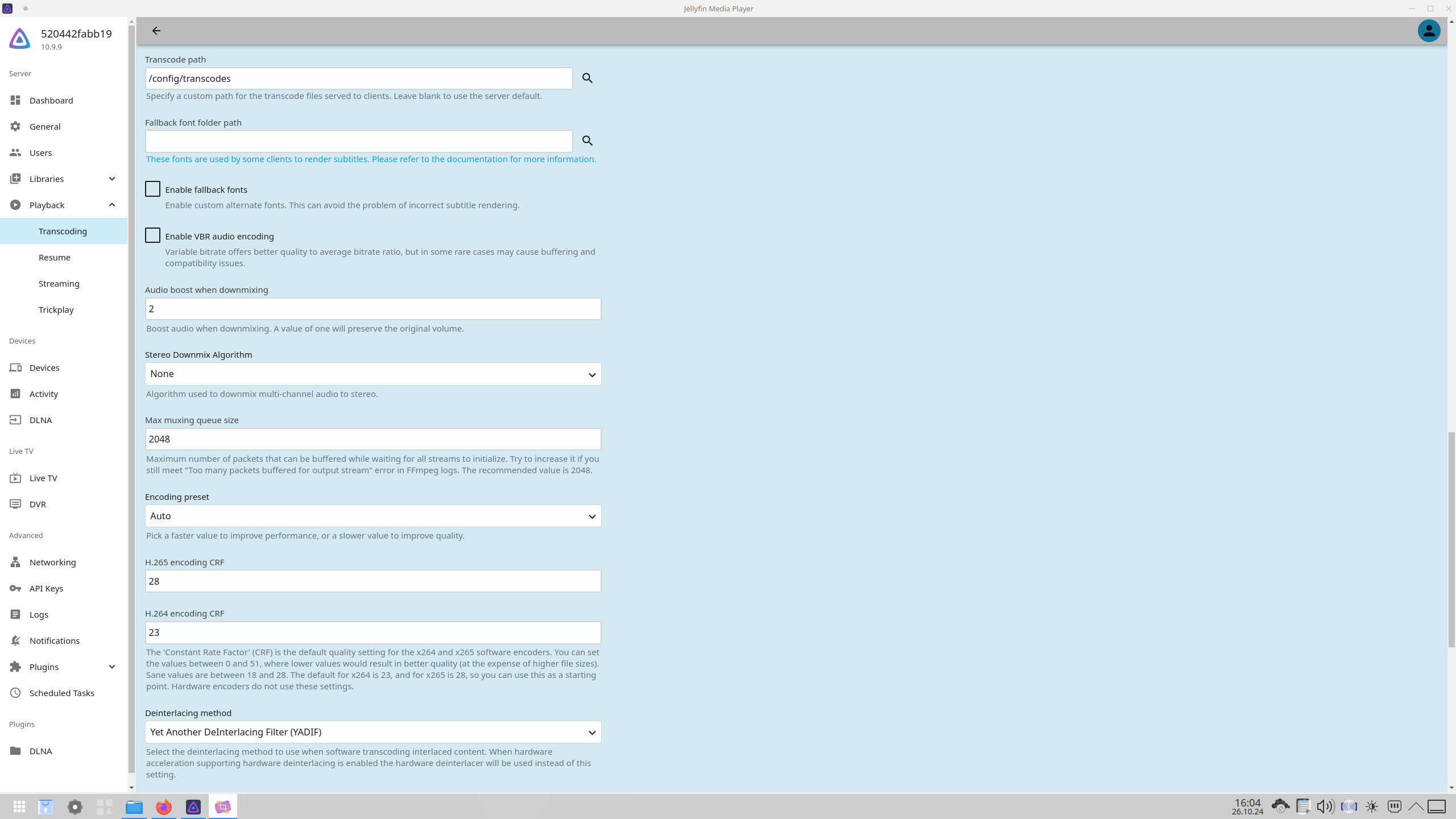

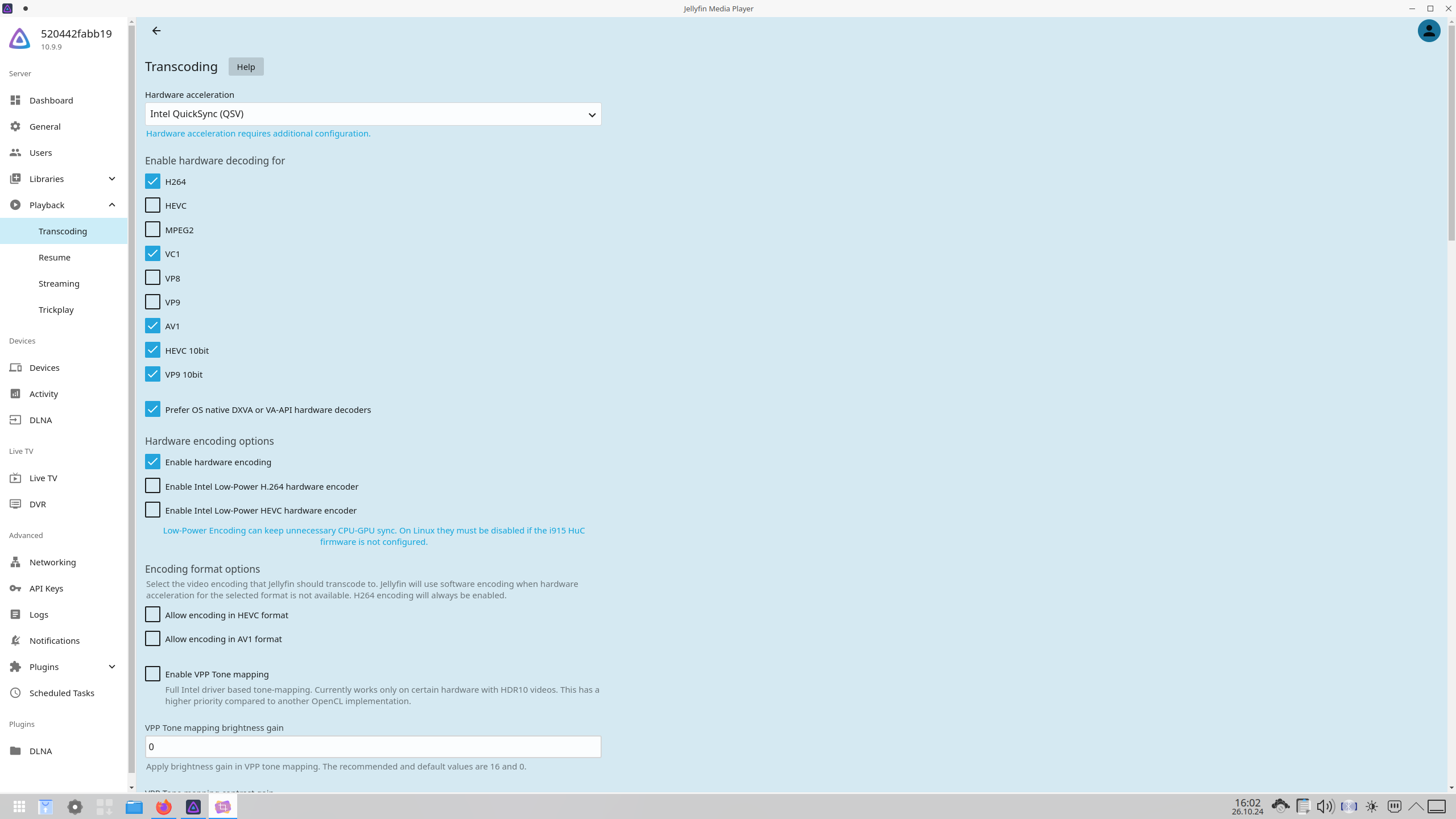

    Can you take a few screenshots of the Transcoding section so see what is selected there?

    2024-10-26, 12:46 PM
    The hardware decoder is not enabled.
    pictures attached
    Nvm thx, I just saw there is a settings for "HEVC" and "HEVC 10 bit"
    Thx, i didnt know there is a option for "HEVC" and "HEVC 10 bit", while transcoding seems to work now, cpu usage is at ~ 15% and intel_gpu_top is busy rendering. It is still struggling to keep a fluent stream. At least gpu transcoding seems to work now,
