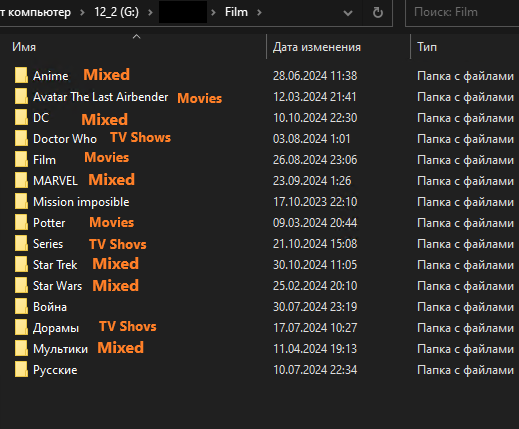

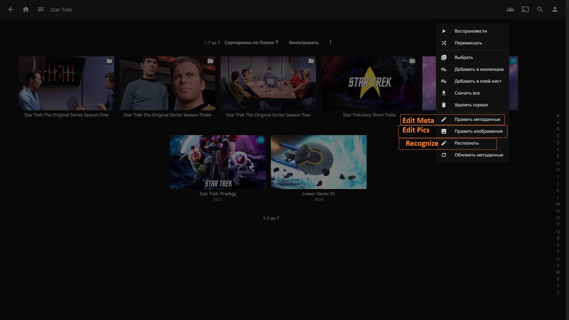

    Hi! I read your answer and i want to say that there are some TV Shows that i can't edit IMDb ID's or others db id's. Some TV Shows have "Recognize" button and i able to edit all ID's installed by default or by plugin.
    Why is that so? How to change it in this case?
    Screenshots shows the problem. I put the translation Smiling-face
    On screenshot 1 it works fine. The second - is the problem. The third works fine too.

    All the shows with a folder icon are not "shows", they are....well, folders. So there is no "show" to "identify".
    Is this a mixed library? And how do you have your files organized. I suspect this is either a mixed library or your organization is non-compliant with our documentation. Or both.

    Yes, it's a mixed folder. Organization is probably non-compliant but some other mixed folders work well. For example Marvel folder. All the TV Shows hasn't "recognize" button but it worked well: file names are just file names, pictures are just frames from each episode. But Star Trek Original series from 1966 - 1968 names become "Turist Ömer Uzay Yolunda" which is Turkish tv show and i can't fix it ... actually i can but i need to change names, IMDb id's of each episode manually.
    As for organization:
    for any universes like Marvel, DC, Star Trek where Movies & TV Shows present i use mixed folders. TV Shows only - just as Jellyfin docs are as well as for the movies and "Recognize" present.
    On my screenshot you can see Star Trek Discovery for example. This is the organization.

    2024-10-30, 03:34 PM
    Yeah. Mixed libraries are buggy and unsupported. There are ongoing discussions of deprecating them entirely.
    That's in addition to your very much non-compliant organization. Why are Discovery's seasons in one folder, but TOS has separate folders at the same level as Discovery for each of its seasons?
    Additionally, it looks like you are nesting all the Star Trek shows in their own folder. Which is also non-compliant. Having this kind of organization can throw off how they are identified. Also, TMDB and TVDB list TOS as simply "Star Trek". So including "The Original Series", in addition to the other organization issues, will cause mis-identification.
