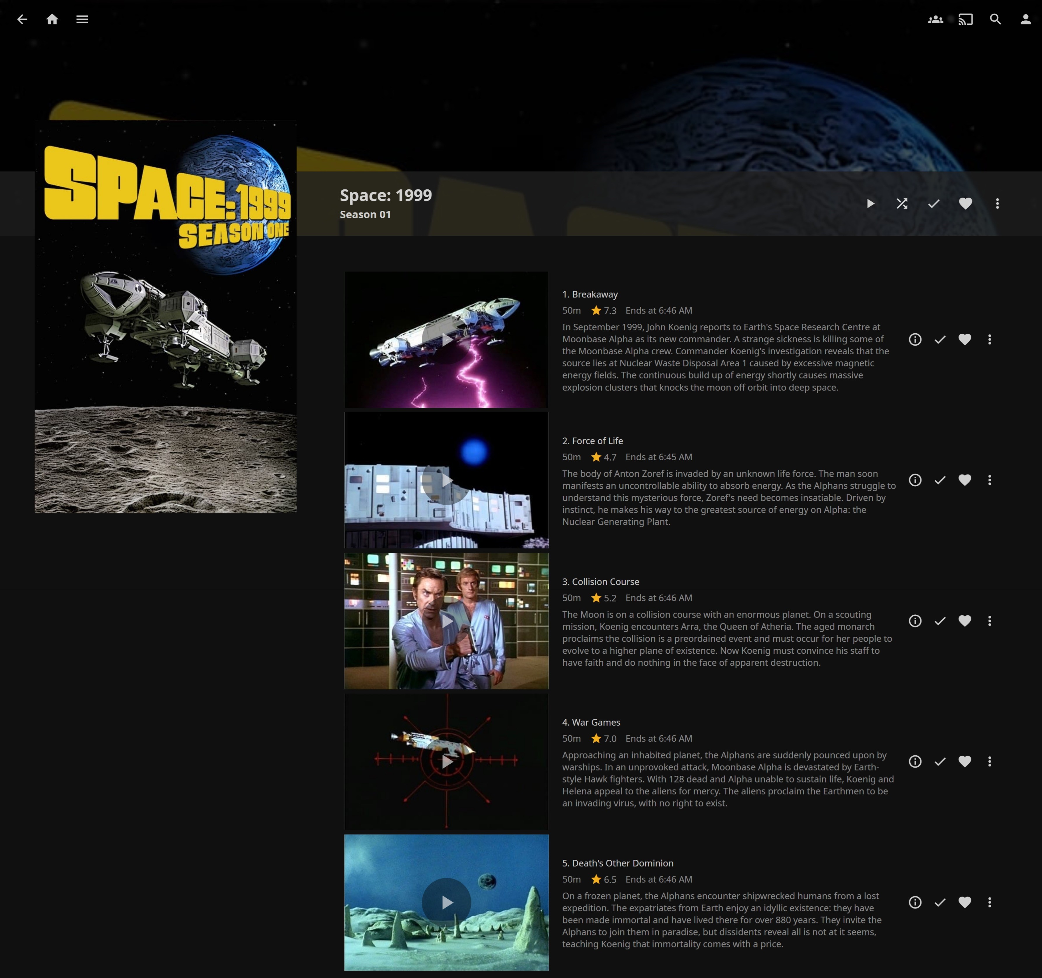

    I had a show with a year in the title that got misidentified and re-done AFTER it had already been in place for a while. The folder named was in the format;
    Series Name (start year) [tmdbid-xxx]
    It had been working fine, had all the correct episode titles and everything. Then it randomly got replaced with a series with a similar name that aired in the year given in the title of the actual series. I thought the purpose of the formatting was to prioritize information? Why did it ignore the tmdbid and overwrite an existing nfo with incorrect data?

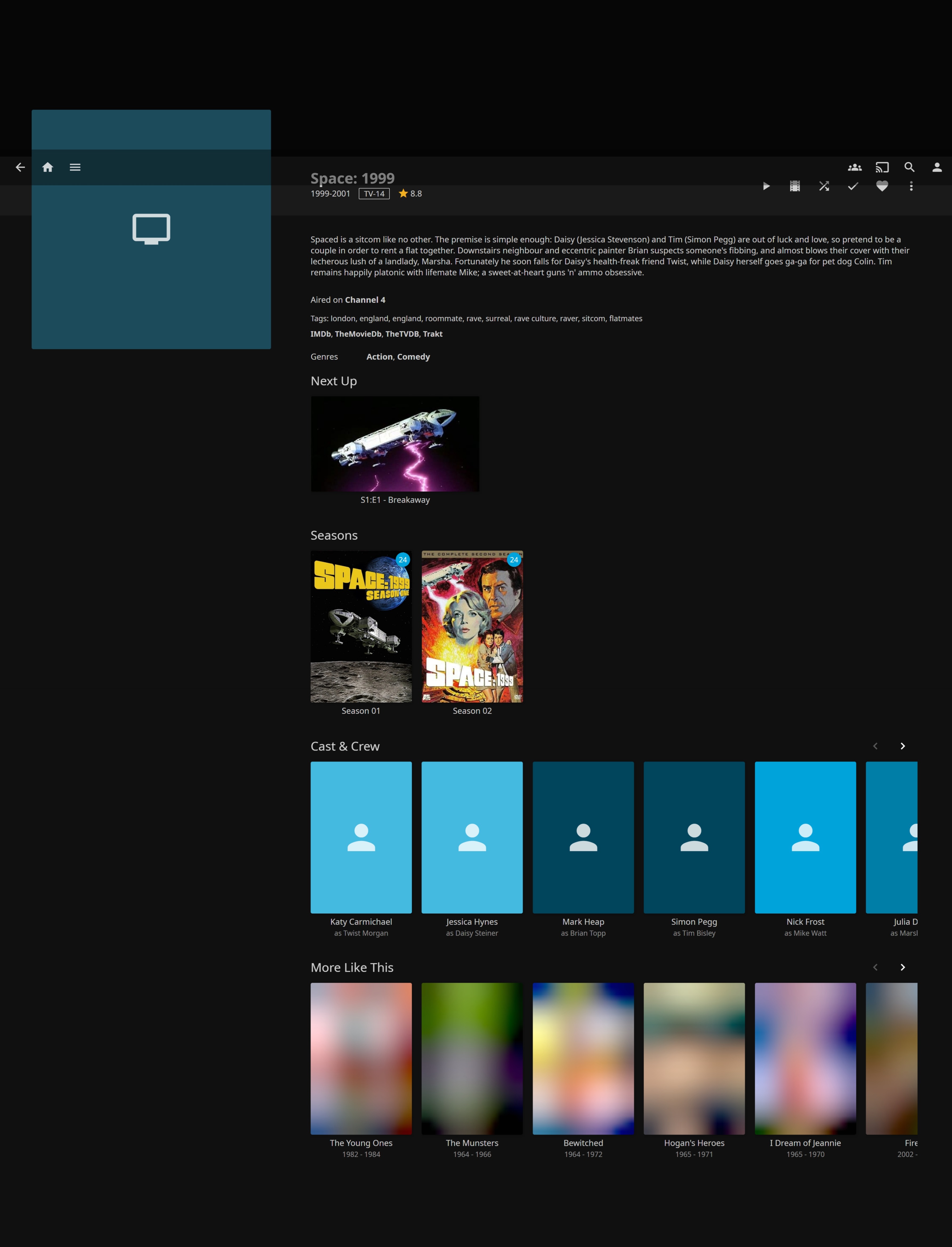

    Okay, it's getting more bizarre. Half the information is right, half is wrong. Even with the correct tmdbid, it pulled in the wrong imdbid. Has the correct show title, but all the rest of the show info is wrong. All the episode nfos are correct.
    <?xml version="1.0" encoding="utf-8" standalone="yes"?>
    <tvshow>
      <plot>Spaced is a sitcom like no other. The premise is simple enough: Daisy (Jessica Stevenson) and Tim (Simon Pegg) are out of luck and love, so pretend to be a couple in order to rent a flat together. Downstairs neighbour and eccentric painter Brian suspects someone's fibbing, and almost blows their cover with their lecherous lush of a landlady, Marsha. Fortunately he soon falls for Daisy's health-freak friend Twist, while Daisy herself goes ga-ga for pet dog Colin. Tim remains happily platonic with lifemate Mike; a sweet-at-heart guns 'n' ammo obsessive.</plot>
      <outline>Spaced is a sitcom like no other. The premise is simple enough: Daisy (Jessica Stevenson) and Tim (Simon Pegg) are out of luck and love, so pretend to be a couple in order to rent a flat together. Downstairs neighbour and eccentric painter Brian suspects someone's fibbing, and almost blows their cover with their lecherous lush of a landlady, Marsha. Fortunately he soon falls for Daisy's health-freak friend Twist, while Daisy herself goes ga-ga for pet dog Colin. Tim remains happily platonic with lifemate Mike; a sweet-at-heart guns 'n' ammo obsessive.</outline>
      <lockdata>false</lockdata>
      <dateadded>2024-07-22 11:03:00</dateadded>
      <title>Space: 1999</title>
      <originaltitle>Space: 1999</originaltitle>
      <trailer>plugin://plugin.video.youtube/?action=play_video&amp;videoid=IXx0pxPD8mY</trailer>
      <rating>8.8</rating>
      <year>1999</year>
      <mpaa>TV-14</mpaa>
      <imdb_id>tt0187664</imdb_id>
      <tmdbid>134</tmdbid>
      <premiered>1999-09-24</premiered>
      <releasedate>1999-09-24</releasedate>
      <enddate>2001-04-13</enddate>
    And the series artwork is correct, but the cast list is wrong.
    The episodes are fine.
    Looks like I should be able to correct the various ID numbers and get it back in shape. Maybe when I enabled the tvdb plugin, it grabbed the wrong info and messed it all up?
