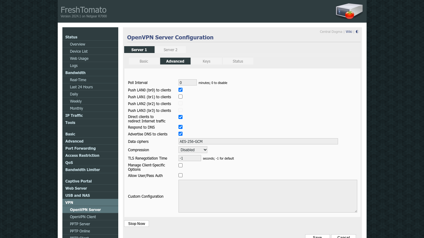

    2024-03-04, 05:12 PM (This post was last modified: 2024-03-04, 05:13 PM by TheDreadPirate. Edited 1 time in total.)
    Do you have the option to simply set up plain OpenVPN on your router?  Pretty sure that is on option on most routers.
    It is just a couple of boxes to configure OpenVPN to push clients to your main VLAN.  The 4 boxes I checked in my screenshot should be similar to what you have available. Checking them will essentially make a private VPN for your phone and other devices.
