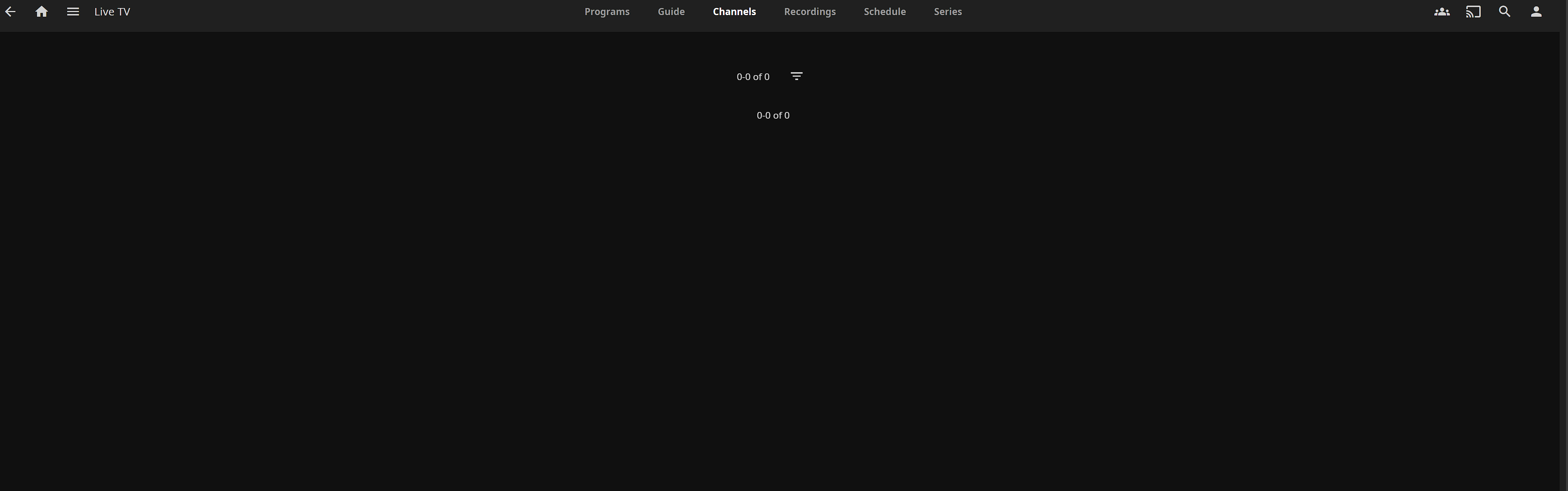

    tv guide is no longer working after upgrade to
    Setting up jellyfin-server (10.9.6+ubu2204) ...
    Setting up jellyfin (10.9.6+ubu2204) ...
    My xmltv.xml file is still being generated but for some reason nothing is appearing in my guide.
    What can I provide to help troubleshoot this issue?
    Here is my xmltv.xml file.
    https://ufile.io/8i3cikdp
    Empty Guide screenshot.  I have deleted and readded the xmltv source and restarted service with no change.
