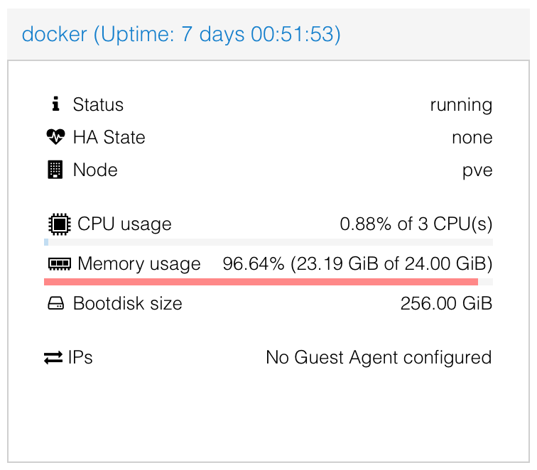

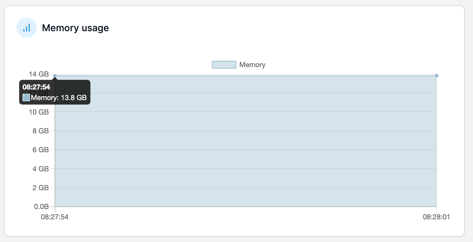

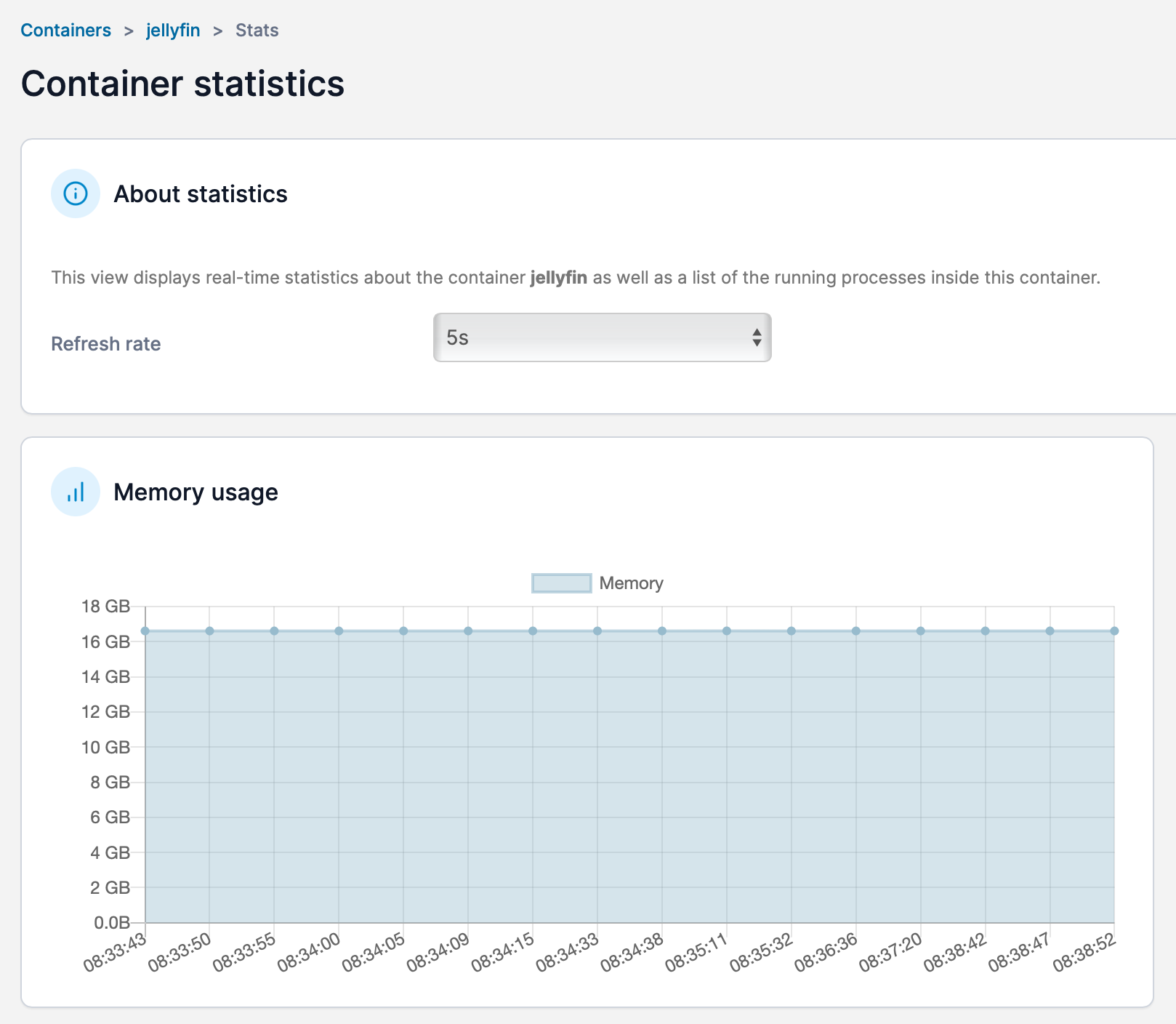

    Hi just installed Jellyfin on my Portainer / Docker setup. The (VM) machine has a total of 24 GB memory assigned to it and Jellyfin quickly grabbed 16 GB (!) capping the VM total memory.
    Is this normal? Jellyfin is not doing much ... I have 1 TV show and 2 Movies ... ?!?

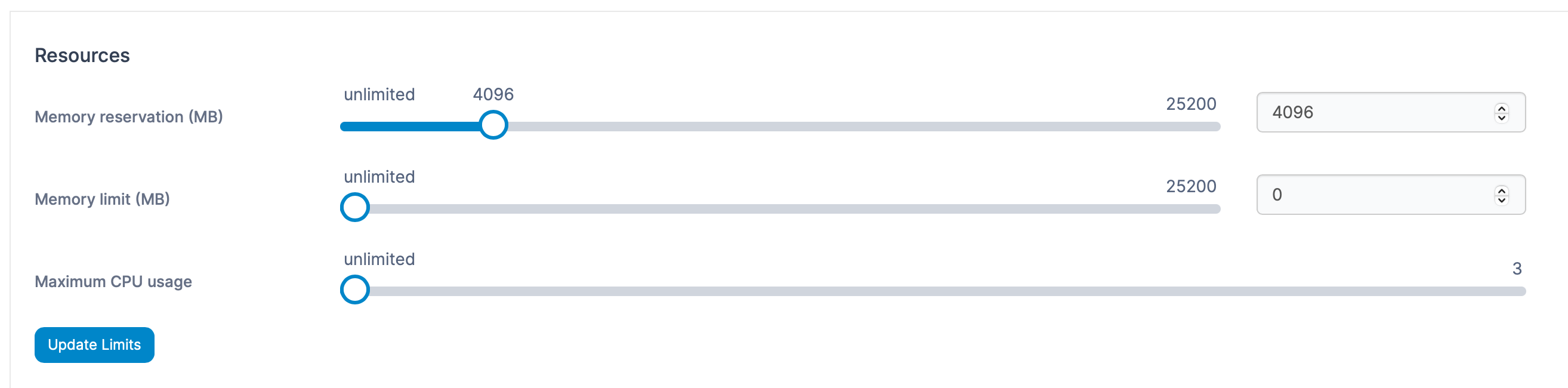

    It is super weird ... I also limited memory reservation of the container to 4GB ... still sitting at a total for 13GB RAM.

    Docker's memory reservation is a soft limit. It means that the next reclaim will attempt to get below the limit, but if it can't then it won't. It won't do anything to stop a memory leak or cause a oom-kill.
    Is it the jellyfin-process taking the memory? Processes running in containers are just normal linux processes, so you should be able to see them with top/htop or whatever process monitoring you have on the host.
