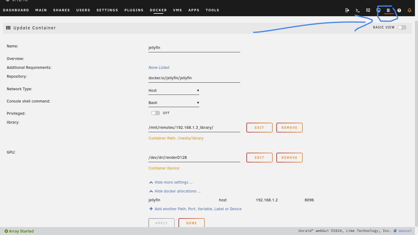

    Did you pass the GPU into the container?  In the menu for the container is an option pass in a device.  Ignore the arrow, this screenshot was taken for another post but I don't feel like booting up unRAID right now.
    jellybelly44
    2024-08-10, 05:05 AM
    [Image: Screenshot-2024-08-10-at-12-16-34-AM.png]
    Looks like I may not have had the GPU passed properly before, but I believe I have it set correctly in the container settings now. Screenshot included above to confirm wehther that looks right.

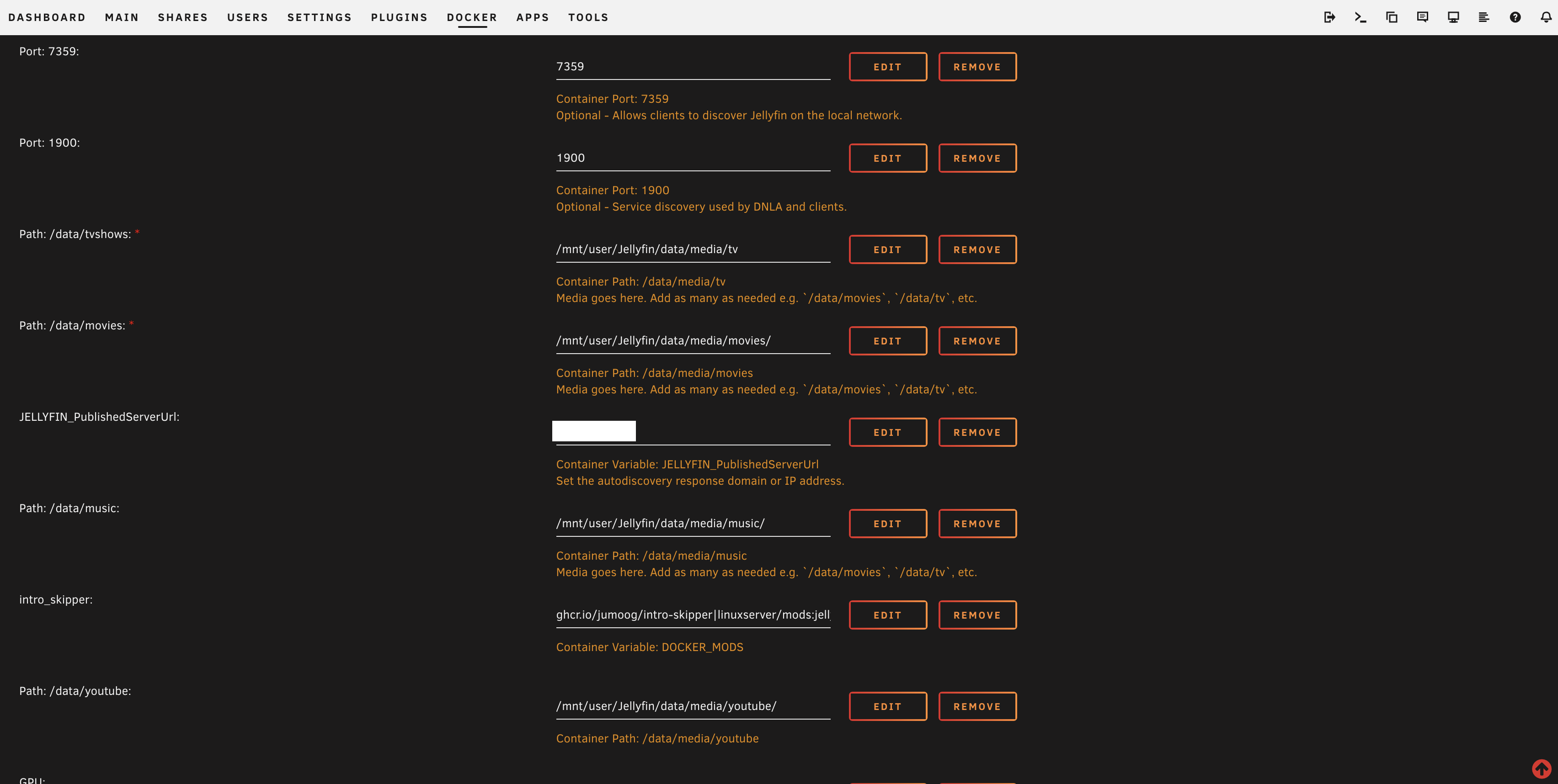

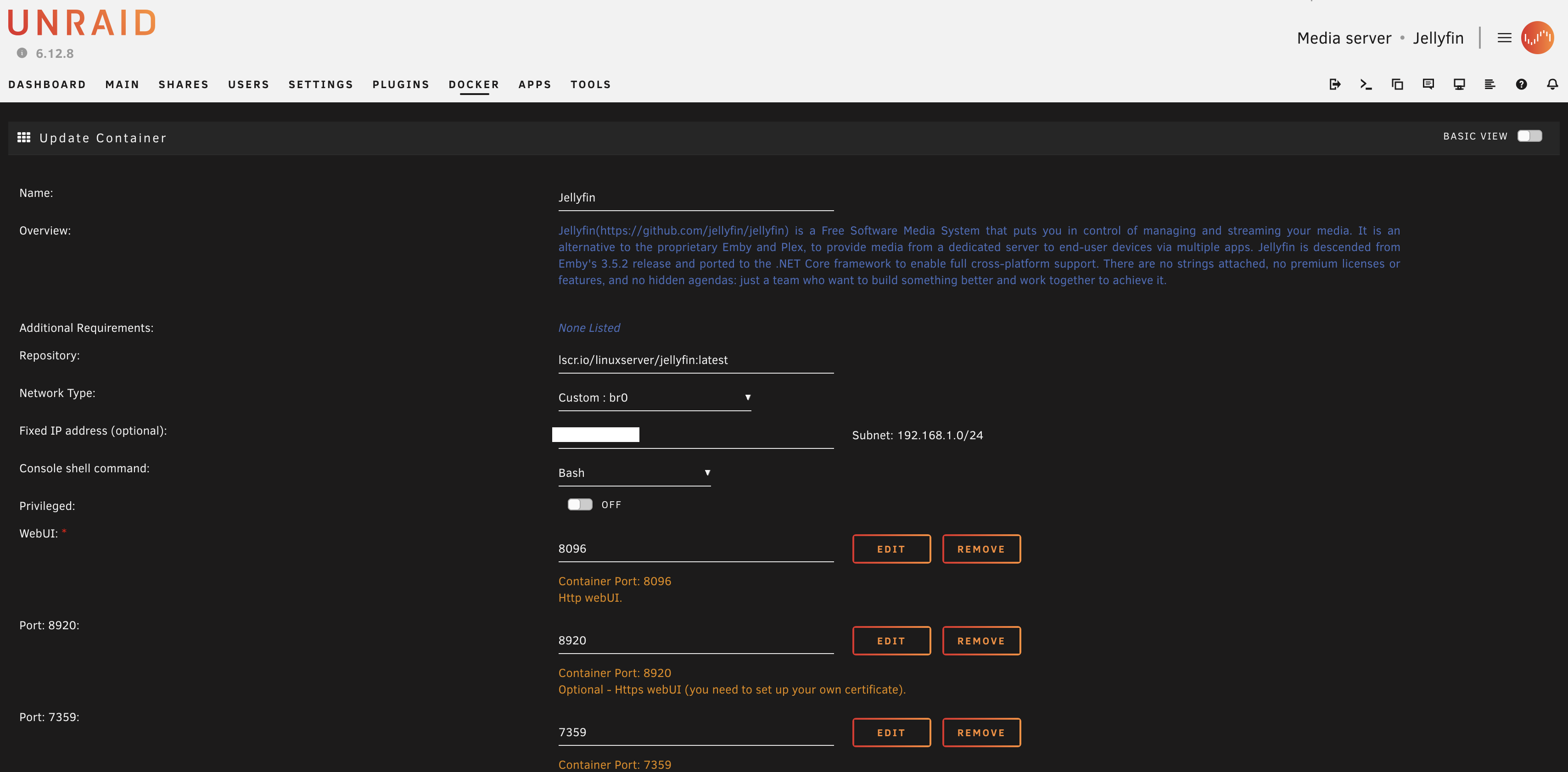

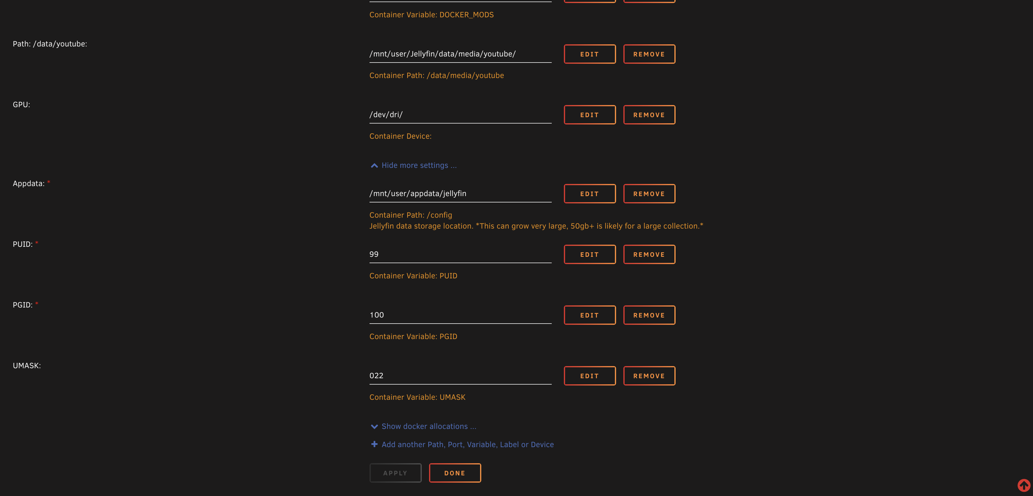

    Can you share screenshots of your docker config?
    jellybelly44
    2024-08-10, 08:24 PM

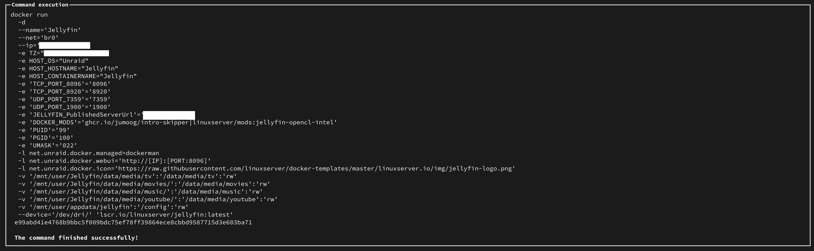

    I've attached screenshots of my Jellyfin container config in the Unraid GUI, as well as a screenshot of what the Docker-run config looks like when it builds.
    2024-08-11, 12:29 AM
    Ok. For some reason the screenshot you shared in your prior post wasn't loading when I asked for them. Sorry.
    I know it shouldn't matter, but instead of passing in /dev/dri, can you specifically pass in the render device?
    /dev/dri/renderD128
