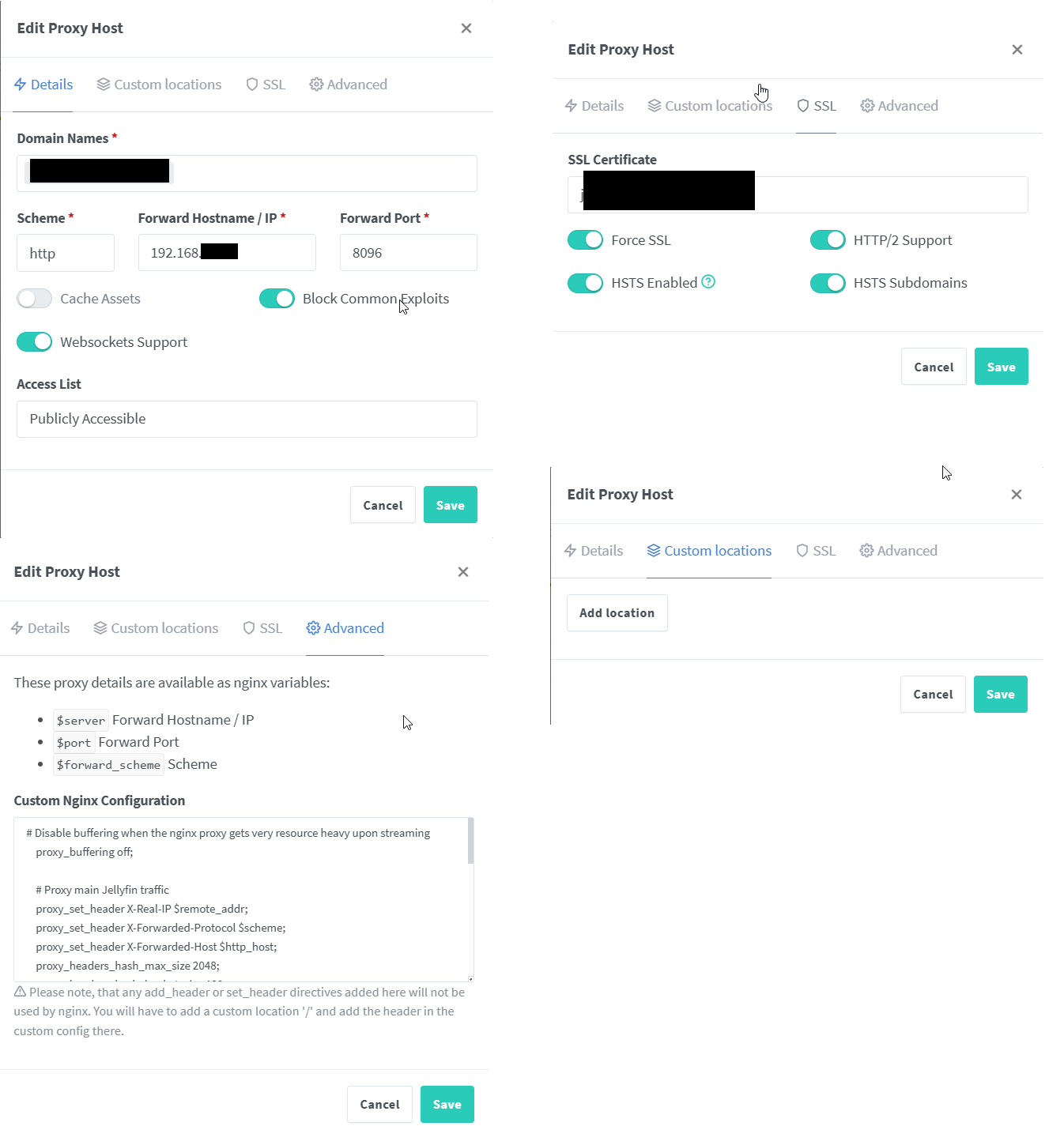

    Can you share screenshots of the Nginx configuration screens? All of the tabs?
    Censor your domain name. Also, I'm assuming you allowed Nginx to acquire the certs via Let's Encrypt?

    The full contents of the Advanced tab are (as recommended in the Nginx section of the Jellyfin Networking docs):
    # Disable buffering when the nginx proxy gets very resource heavy upon streaming
        proxy_buffering off;
        # Proxy main Jellyfin traffic
        proxy_set_header X-Real-IP $remote_addr;
        proxy_set_header X-Forwarded-Protocol $scheme;
        proxy_set_header X-Forwarded-Host $http_host;
        proxy_headers_hash_max_size 2048;
        proxy_headers_hash_bucket_size 128;
        # Security / XSS Mitigation Headers
        # NOTE: X-Frame-Options may cause issues with the webOS app
        add_header X-Frame-Options "SAMEORIGIN";
        add_header X-XSS-Protection "0";
        add_header X-Content-Type-Options "nosniff";
        # Content Security Policy
        # See: https://developer.mozilla.org/en-US/docs/Web/HTTP/CSP
        # Enforces https content and restricts JS/CSS to origin
        # External Javascript (such as cast_sender.js for Chromecast) must be whitelisted.
        # NOTE: The default CSP headers may cause issues with the webOS app
        #add_header Content-Security-Policy "default-src https: data: blob: http://image.tmdb.org; style-src 'self' 'unsafe-inline'; script-src 'self' 'unsafe-inline' https://www.gstatic.com/cv/js/sender/v1/cast_sender.js https://www.gstatic.com/eureka/clank/95/cast_sender.js https://www.gstatic.com/eureka/clank/96/cast_sender.js https://www.gstatic.com/eureka/clank/97/cast_sender.js https://www.youtube.com blob:; worker-src 'self' blob:; connect-src 'self'; object-src 'none'; frame-ancestors 'self'";
    Yes, the SSL cert was created by NPM using letsencrypt.  As mentioned, access works fine with some clients but not others.
