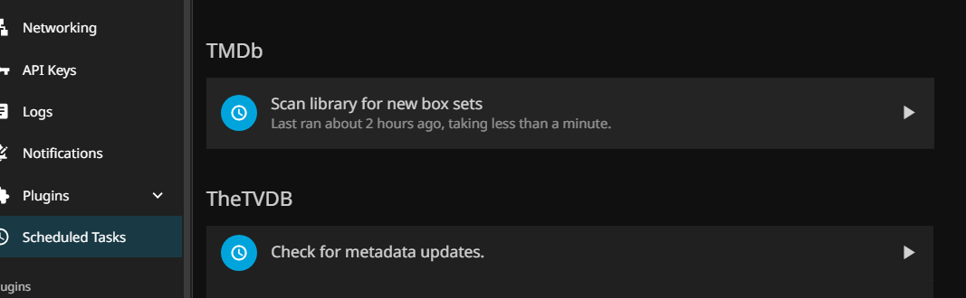

    As I'm typing this I see that the TMDb plug-in has a scheduled task of updating box-set information. I'm guessing this is whats causing this. I'm not seeing the option to uninstall the plug-in. I'm going to remove the scheduled task and see if that resolves the issue. If it does not I will update here. Any other thoughts or input would be greatly appreciated!

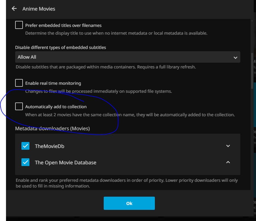

    In the library settings, did you enable "Automatically add to collection"?
    The scheduled job you talked about is only present if you have the TMDB Boxset plugin installed, which you did not list.  It is not part of the base TMDB plugin, which comes with Jellyfin and can't be easily removed, nor should it be removed.
    On my test Jellyfin I do have that plugin installed and the schedule job is present.
    On my main Jellyfin I do not have the TMDB Boxset plugin installed and the job is NOT present.

    "Automatically add to collection" is disabled in the Libraries setting.
    I'm thinking is was because of the Scheduled Task to check for new Box-Set info by the TMDb plug in. I removed the scheduled task so I'm hoping that prevents it. I'll report back if the issue persists.
