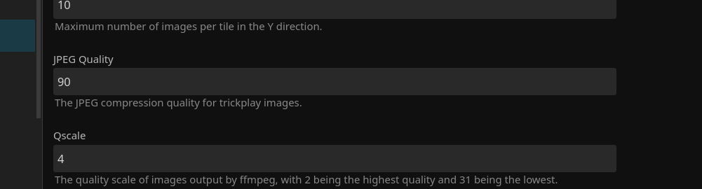

    In the trickplay settings there is nothing having the number 472. I added my screenshots https://ibb.co/DkgLJ4m
    https://ibb.co/h91mp4v
    https://ibb.co/pXZ02gL
    Edit: If I select 5 instead of 4 in the Qscale, it gives me the error with 590 instead of 472, with 2 it gives 236

    Open up /etc/jellyfin/system.xml. What is in this code block for you?
