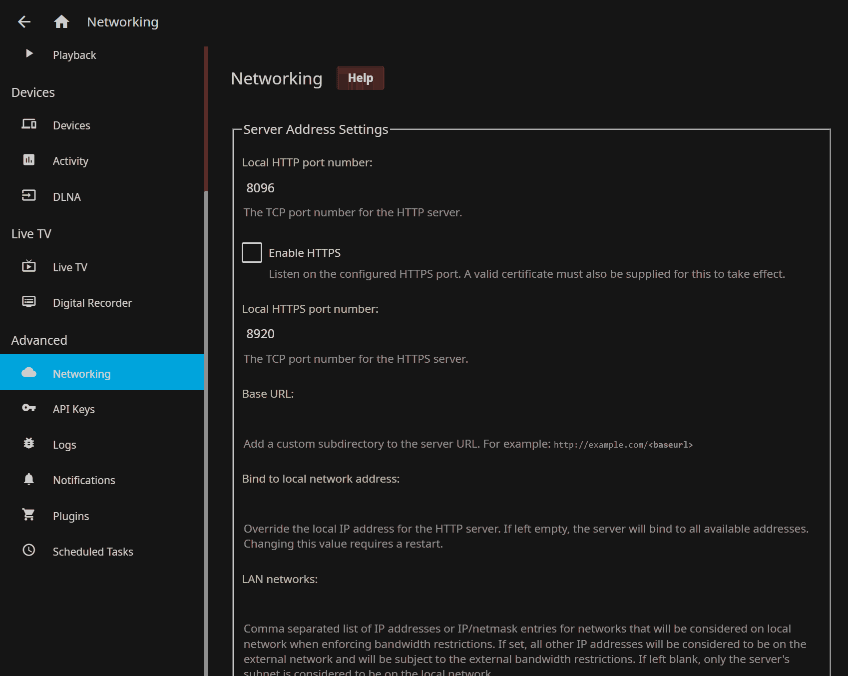

    I have no such luck with Jellyfin when trying to replicate these sorts of settings. Remote access is enabled. Beyond that i'm pretty much stuck. I tried to edit the jellyfin config file but I could never get that to work either. I'm getting a lot of errors and i'm not sure which ip address i'm supposed to use (ubuntu server, docker container etc) and where. As it stands i'm only able to even access the jellyfin gui by using the private Ip of my ubuntu server machine followed by 8096. Which is allowed by my firewall rules. I'm going to try the tailscale route next.

    To actually answer your question, you need to configure nginx to so that when you access whatever port on nginx it then forwards that traffic to jellyfin port 8096. Create a new proxy host, specify the IP of jellyfin, port 8096, http protocol.

    • After setting up the Jellyfin VM, make sure you're able to access Jellyfin webui from other computers on the network, without the reverse proxy involved (http://192.168.1.5:8096 or similar)
    • You might need to open port 8096 on your Jellyfin VM
    • Once you know for sure that this works, configure Nginx Proxy Manager and whatever DNS records are needed
