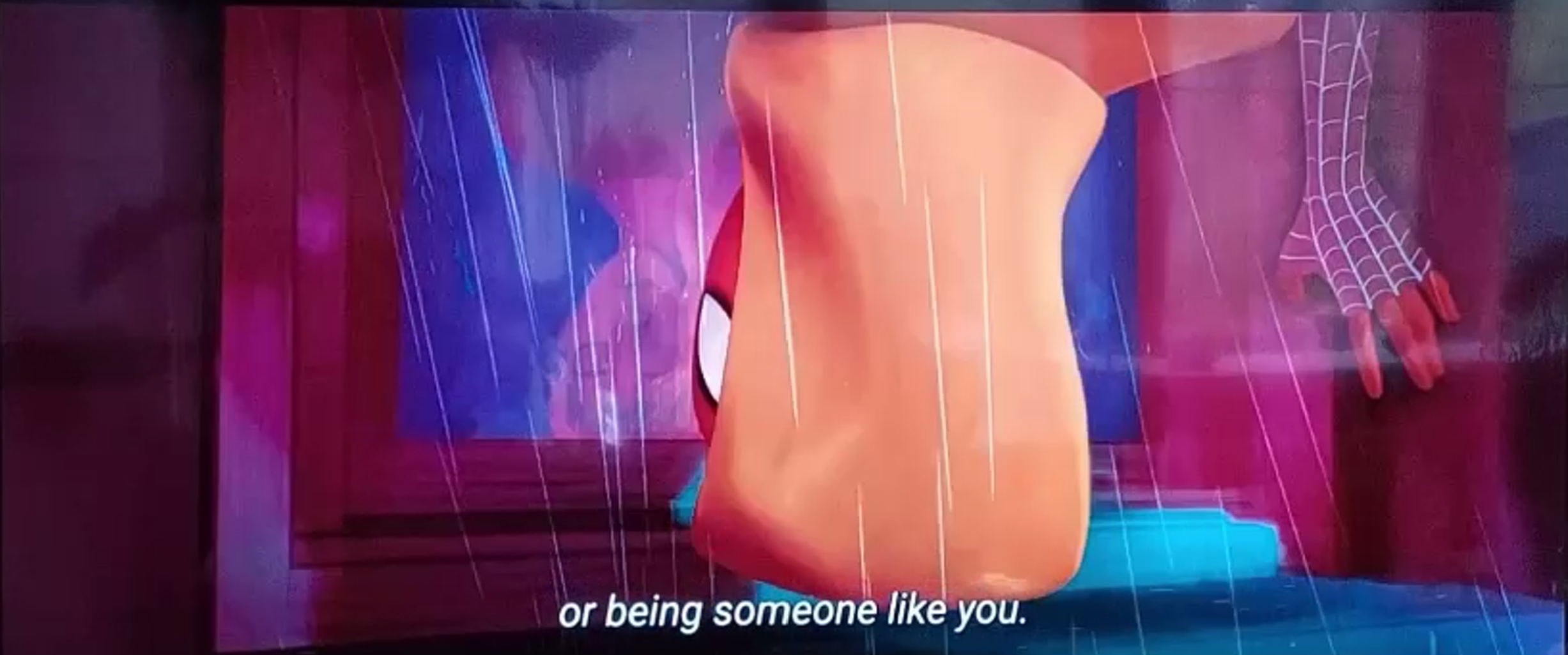

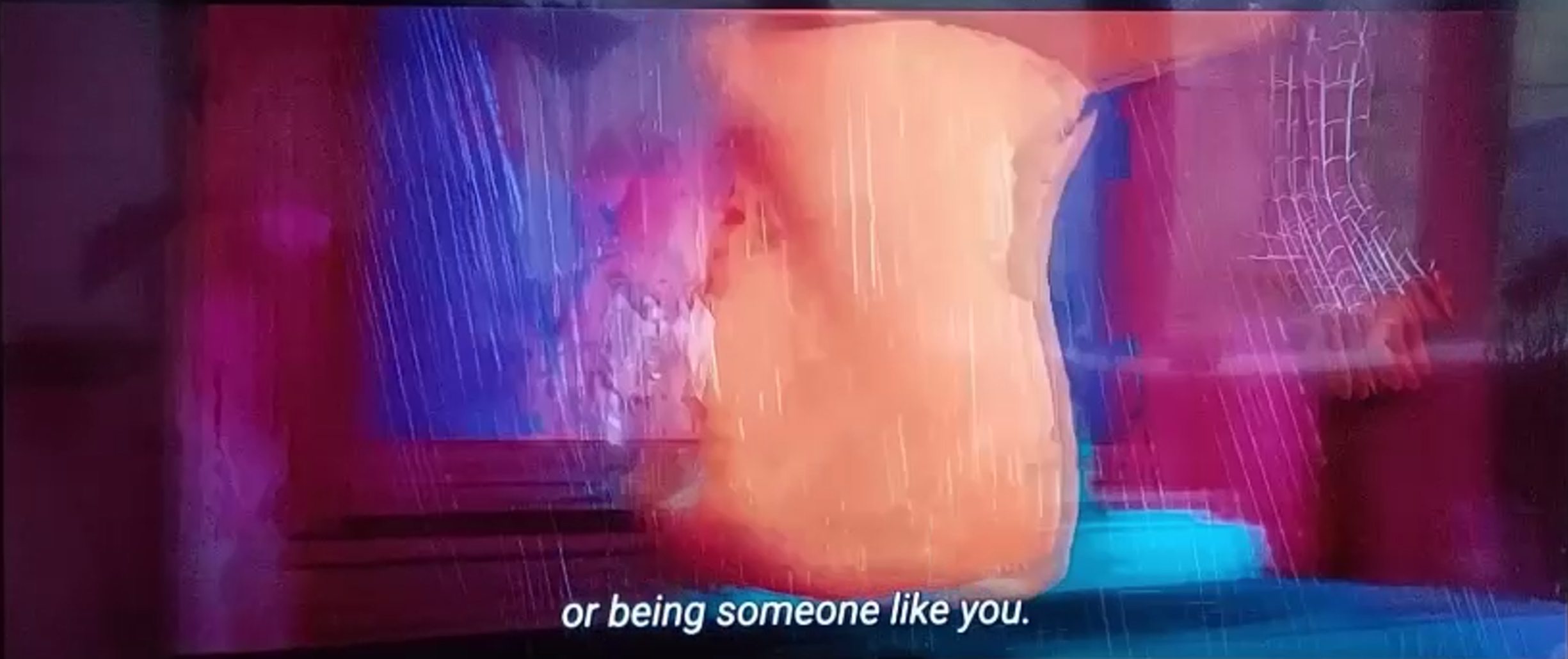

    I've been having this weird issue where the video "shakes"/becomes blurry for a frame. It seems to mostly happend with a static background with a foreground element that's moving.
    I've tried switching video players but that hasn't helped and I haven't seen it happen in any apps other than Jellyfin.
    Android tv is the only client in which this is happening the Jellyfin mediaplayer doesn't have this problem.
    Is there any way to fix this?

    Yeah sorry about the the delay but I figured it out. It had nothing to do with jellyfin. It was the tv's framerate insertion thingy trying to smooth out the framerate and horribly failing.
