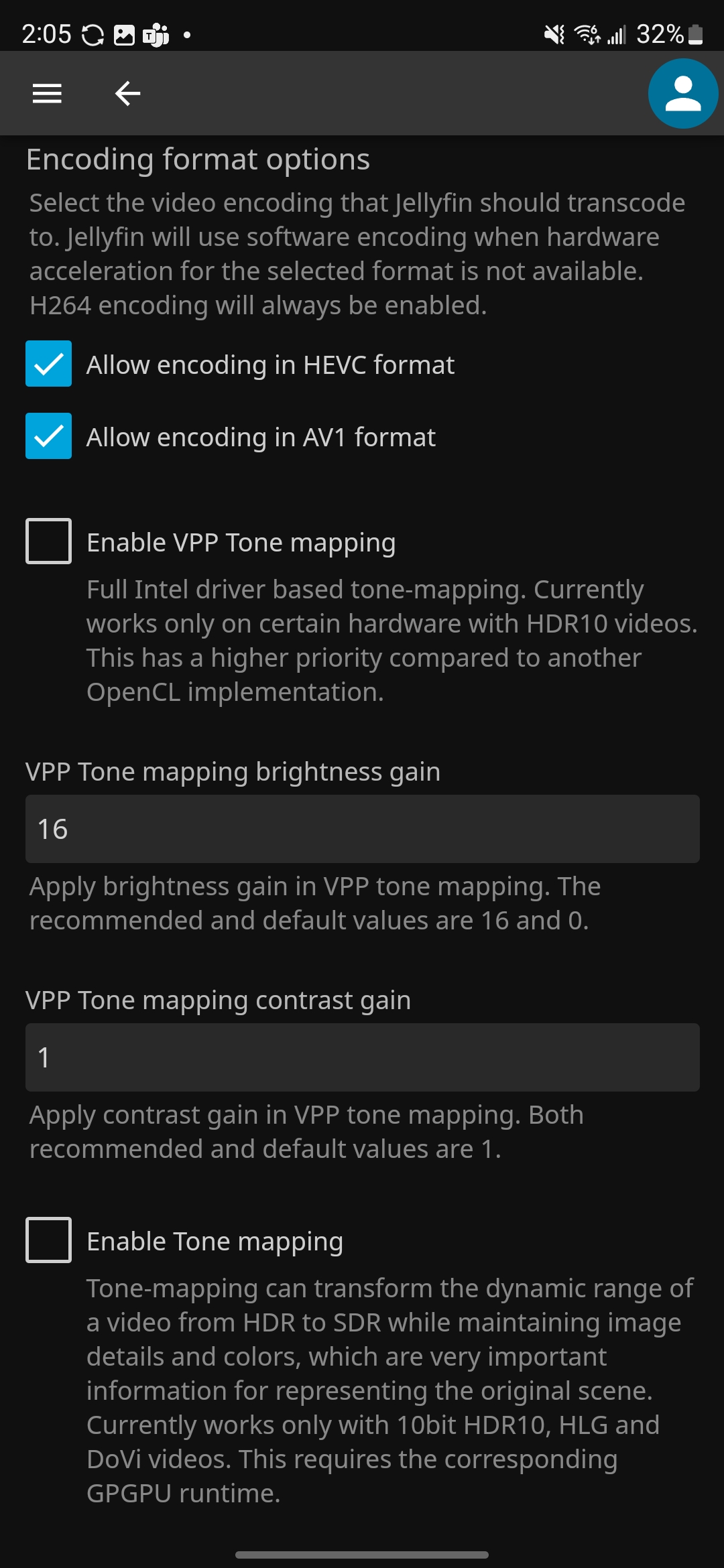

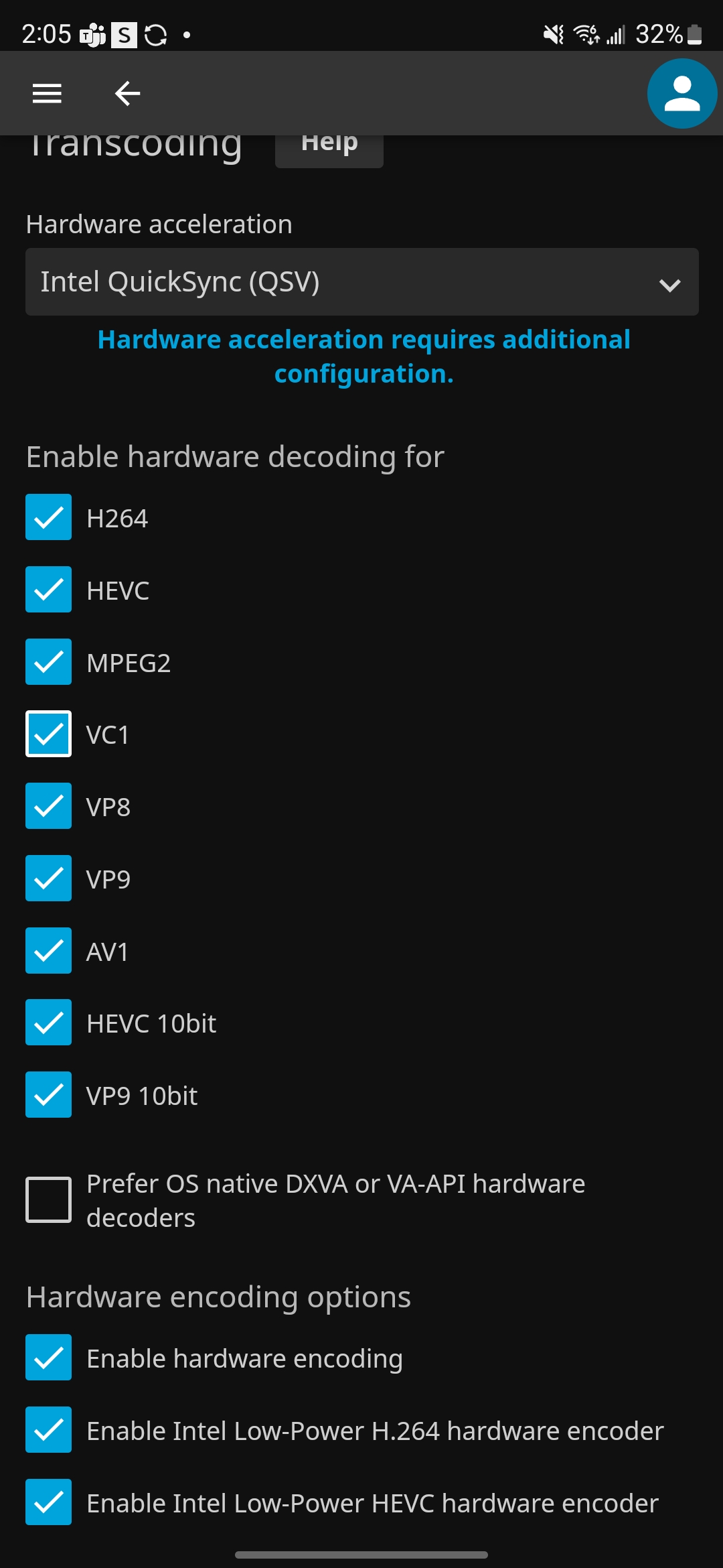

    I get 100% cpu usage with ffmpeg even though I have hardware acceleration turned on in the form of QSV, I triple checked all drivers and made sure everything is up to date, attached are some images of some of my settings.
    any help in this area is GREATLY appreciated

    Can you share your ffmpeg logs?
    Also do the following.
    Uncheck VP8 - Not supported by Arc
    Uncheck VC1 - Not supported by Arc
    Check Prefer OS Native DXVA
    Check VPP tone mapping
    Check tone mapping

    dang, I was under the impression that the a770 was the one gpu that supported av1, at least that's what it says in intels documentation, will turn it off, at this point, what do I have to lose? igpu has been disabled, I double checked to make sure and it was, going to have to figure out a way to post the log that doesn't create a page longer than most elder scrolls
