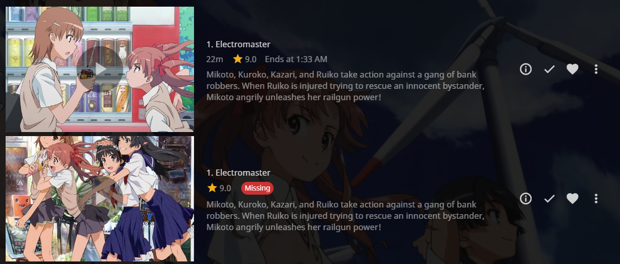

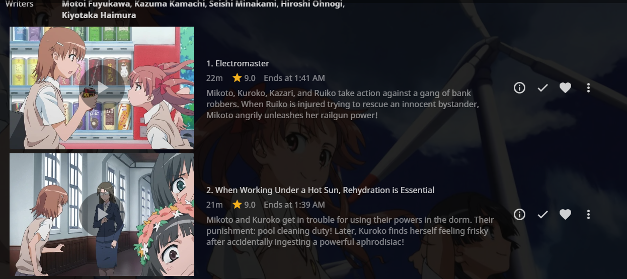

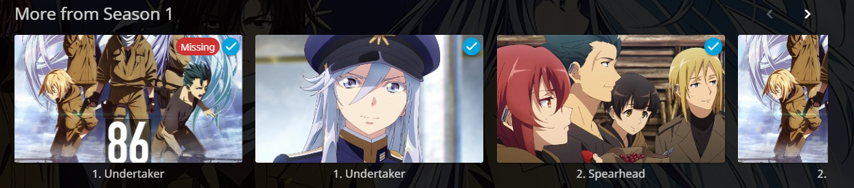

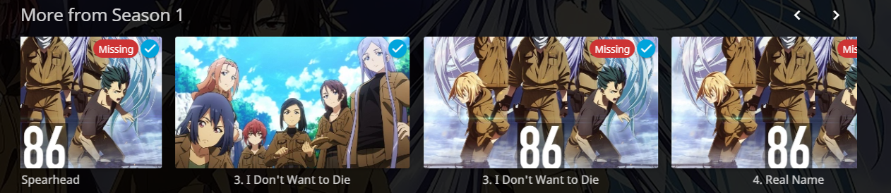

    Been struggling with this issue for the last few days, on a few select series jellyfin is displaying a duplicate missing episode for every single episode in the season.

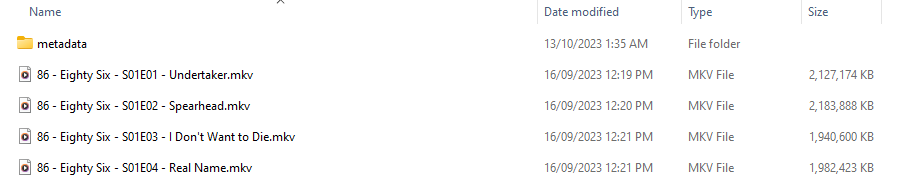

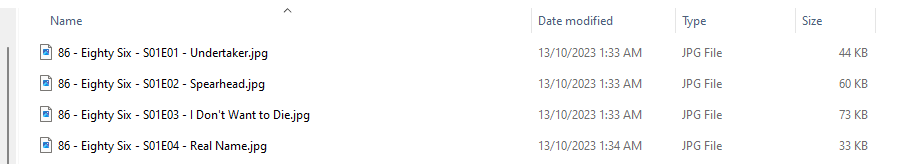

    When looking in the media directory there are no duplicate files or metadata.
    I have tried refreshing the metadata for just the series as well as doing it for the full library, this has persisted through restarts of the server.

    It's all named using the TVDB naming. as far as 86 goes, for 86 it does show as "86: Eighty Six" on TVDB.
    I'll experiment with naming conventions, I would have thought if my naming using TVDB's names was causing problems it would have shown sooner, as its only a handful of series out of a few thousand with issues.

    Its not exclusive to shows with numbers in their name, as I had half a dozen broken series.
    however i have had a bit of luck with a fix, if not a root cause of it.
    Turning "display missing episodes" off in the user settings, Then deleting the meta data from the bugged series, doing a rebuild of the missing metadata and then turning the "display missing episodes" back on has worked for removing these episodes, I tried deleting the metadata multiple times both through jellyfin and directly through file explorer, but until I turned off display missing episodes first it never worked.
