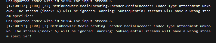

    What does this mean? Also it wasn't grabbing anything so i disabled one pace before i read your reply

    2023-10-17, 09:16 PM (This post was last modified: 2023-10-17, 09:17 PM by TheDreadPirate. Edited 1 time in total.)
    If I had to guess, it is the subtitle extractor job failing to read a TTF subtitle track.

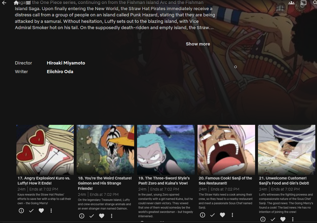

    Ended up doing the replace metadata thing and now it looks like this, what do i even do here i thought it just did one piece

    #15
    2023-10-18, 01:20 AM
    Depends on where you initiated the scan. If you used the context menu for One Piece and scanned (replace metadata) that would only do One Piece. If you initiated from the library/home screen/dashboard it would do the entire library.

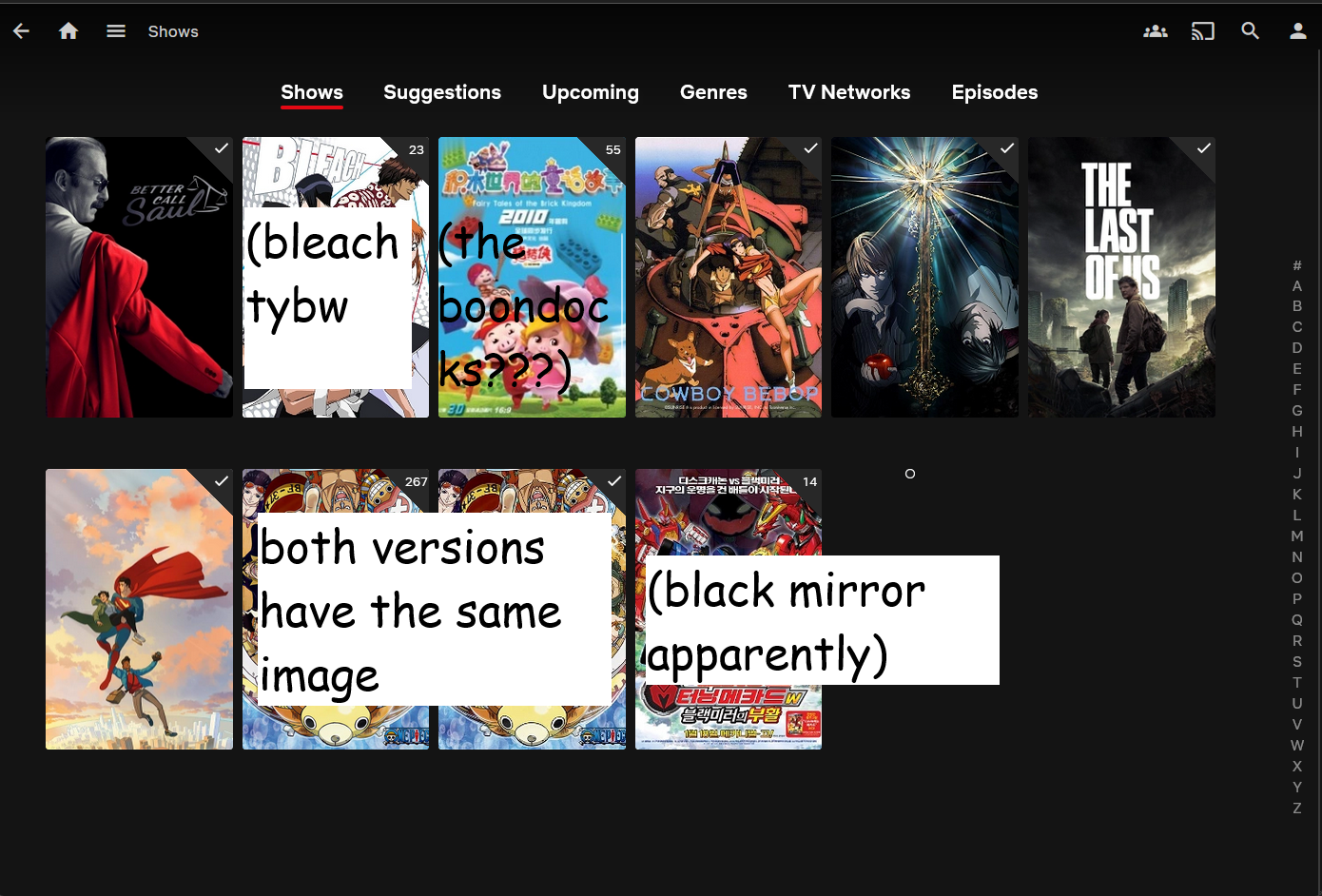

    2023-10-18, 01:46 AM
    Ended up redownloading one piece so it would do the default metadata, it grabbed the 2023 version instead of the 1999 version, is there a way to only change the metadata for the series and not the episodes or do i have to do it manually

    #17
    2023-10-18, 12:39 PM
    In Jellyfin, expand the context menu and "Identify". Enter the ID for 1999 One Piece from TMDB or whichever source and Jellyfin will automatically replace the 2023 metadata with the 1999 metadata.

    2023-10-23, 04:14 AM (This post was last modified: 2023-10-23, 04:14 AM by millionsofplayers.)
    Coming back to this thread, I tried that and while it works (and I have episode titles now) now there’s a duplicate of the season with no metadata at all so it’s really annoying to scroll through
    I’ll post screenshots later if I remember

    #19
    2023-10-23, 05:06 PM
    Try rescanning just the show and select replace all metadata. I wonder if it left copies of the previous entries when you identified the show.

    #20
    2023-10-23, 06:08 PM
    (2023-10-23, 05:06 PM)TheDreadPirate Wrote: Try rescanning just the show and select replace all metadata.  I wonder if it left copies of the previous entries when you identified the show.
    Seems to work now
