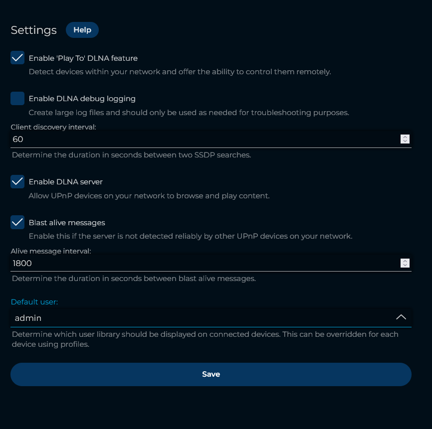

    As I have some 3D movies I wanted to watch them on my Meta Quest 2. For this I use BigscreenVR. I enabled DLNA in my Jellyfin settings, my Quest is connected to the same network as the server. But I still cannot connect with DLNA, it says that there aren't any DLNA servers around.
    I am very new to DLNA and I'm not sure what I did wrong. If anyone could help me I would be very grateful. Thanks!
    My DLNA settings:

    Try lowering the alive message interval significantly, that might help.

    I just tried 1 second and 5 seconds with Jellyfin restart but BigscreenVR still says that it couldn't find it.
