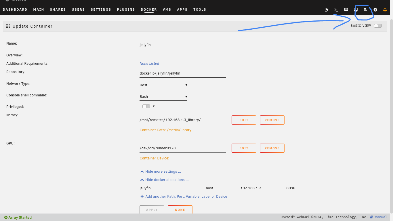

    2024-07-23, 08:25 PM (This post was last modified: 2024-07-23, 08:27 PM by TheDreadPirate. Edited 1 time in total.)
    I see the logs, but its not clear what is causing it.
    I saw your comment on a github thread where you said you were on Unraid.  Can you go to the Unraid console to see if there are any logs that could point to something Unraid is doing in the background that could be the root cause?
    I have Unraid in a separate test setup and I'm still familiarizing myself with it.
