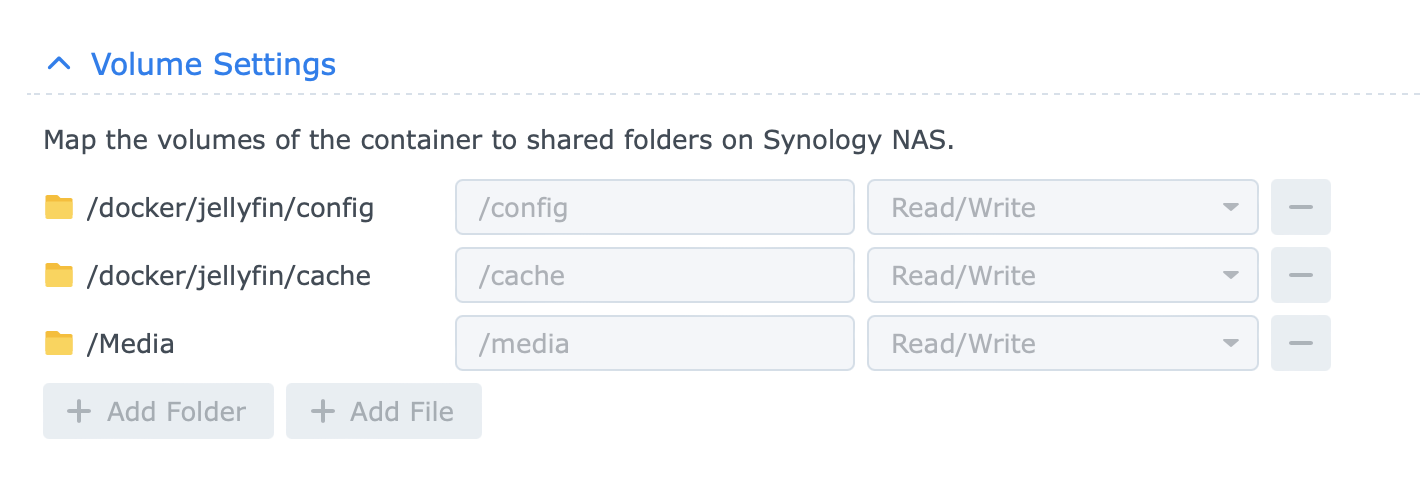

    Looking at the picture of your container's volume settings, you linked the folder wrong.
    You have it linked to the directory "/Media".
    Turn off the container, then edit the path to be "/volume2/Media/".

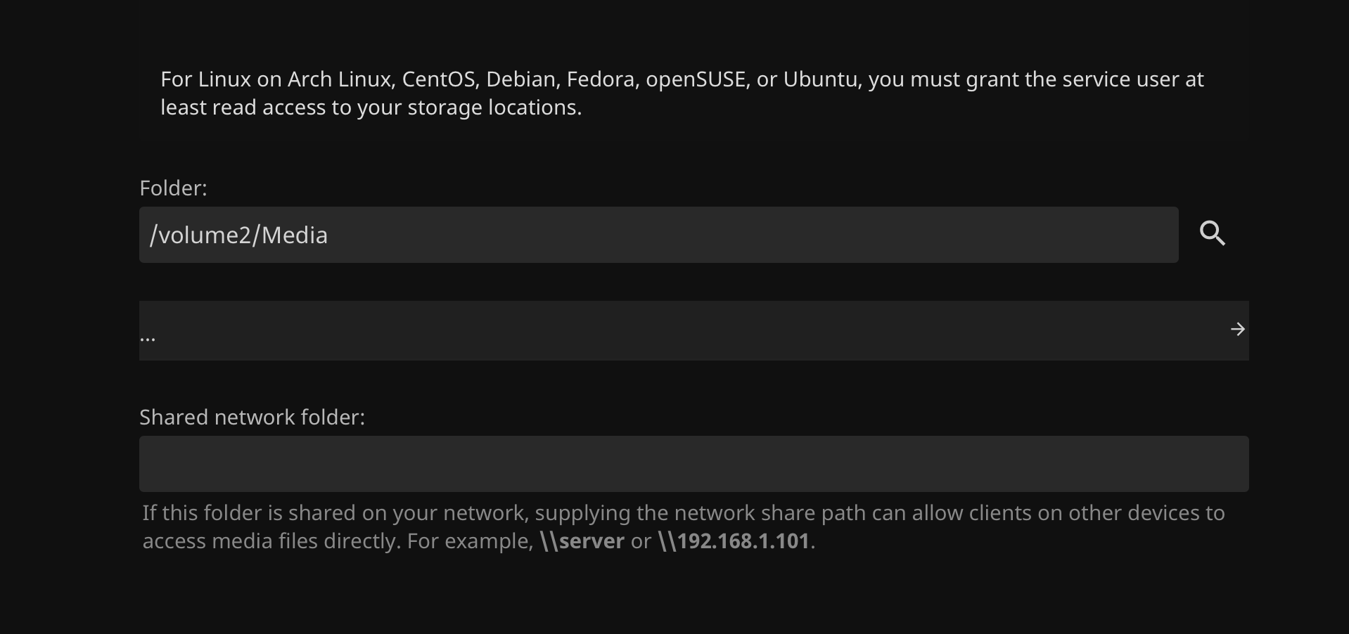

    No luck.  I uploaded pictures of what I tried and Jellyfin still does not see anything.  When I click add folder in the container settings and select my media folder, it just shows up as /Media regardless.  I tried adding /volume2/Media/ to the text box next it and re-adding the library but it still sees nothing.  Not sure how to get root UID and GID and if I remove the line entirely, I have to create the entire container again?

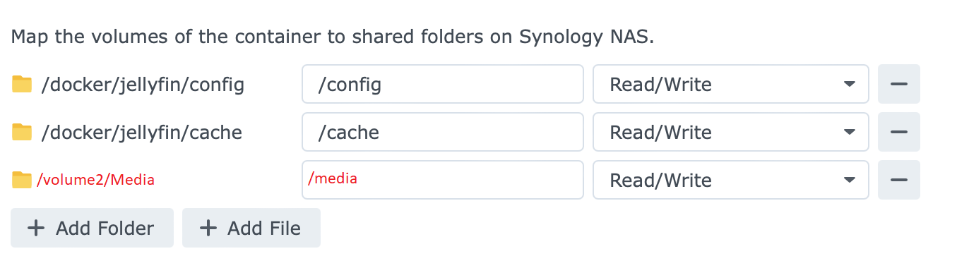

    This is what it should look like, I think.

    (2024-02-14, 08:08 PM)aptmx Wrote: No luck.  I uploaded pictures of what I tried and Jellyfin still does not see anything.  When I click add folder in the container settings and select my media folder, it just shows up as /Media regardless.  I tried adding /volume2/Media/ to the text box next it and re-adding the library but it still sees nothing.  Not sure how to get root UID and GID and if I remove the line entirely, I have to create the entire container again?
    you're looking at it backwards, the left side is the volume on Synology, the right side is the path in the docker where Jellyfin will access it
    look at TDPs screenshot above

    Yeah, delete the current reference to "/Media", then relink the correct one. The Correct mount path will still be "/media".
    Also make sure to edit your script correctly because that will probably rewrite this change the next time you run it.

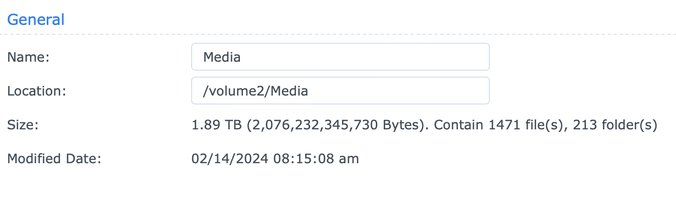

    I am not able to make it look like that though?  When I click add folder, it just lets me choose a shared folder and when I click Media, it just shows up as /Media. There is no way that I see to specify volume2 anywhere.  It just automatically chooses Media and is displayed as /Media.  See attached screenshot.
    Even though the Media folder is on Volume2, the NAS does not see that when trying to map this in the volume settings within the container. It only sees the Root folders regardless of what volume they are on....

    I tried googling how Synology handles showing you multiple volumes and the best I found is this: https://www.reddit.com/r/synology/commen...t/cyf41tt/
    On my Synology NAS, I only have one volume, but I'm thinking that if you scroll down that list of folders when you try and add them, you will find another "Media" folder that will actually be on volume2.
    I don't understand why Synology can't show which volume you're actually using.
