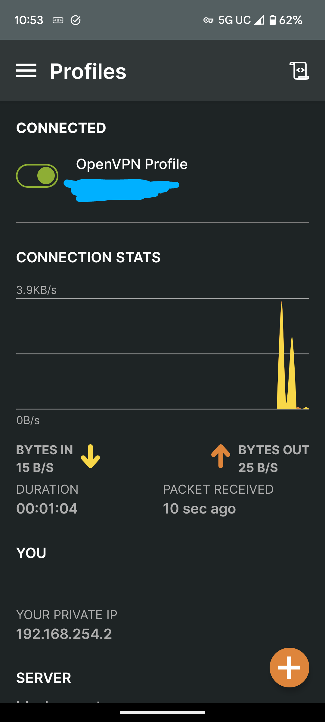

    Having the VPN on the router does not negate the need to have the VPN installed on all clients.  How would the client know how to connect if the client does not have the VPN client running?
    I also have a VPN hosted on my router (for server admin stuff, not for Jellyfin) and I definitely need to have the client running on my phone.
