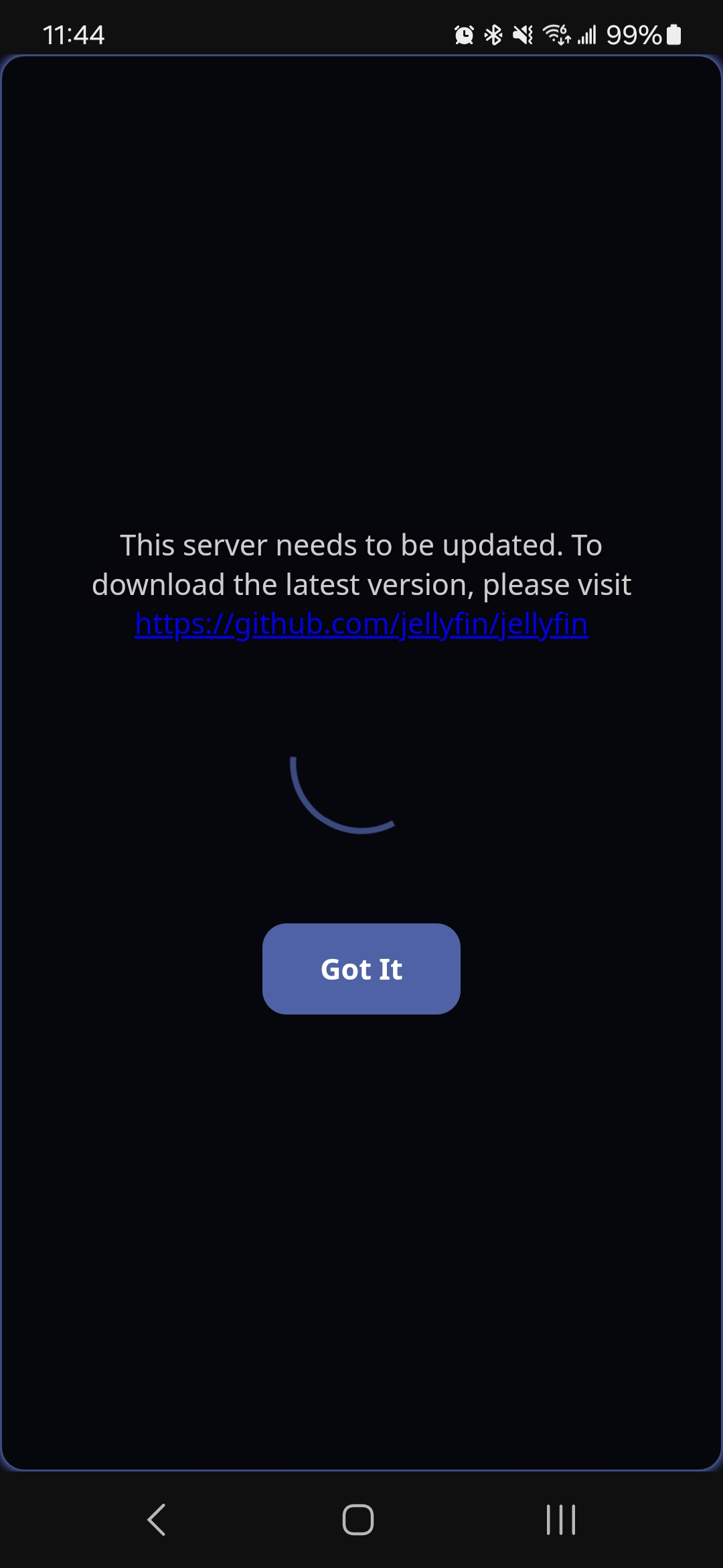

    50% of the time I open Jellyfin 10.9.2 it tells me:
    This server needs to be updated. To download the latest version, please visit https://github.com/jellyfin/jellyfin
    "I tap or click "Got It", it shows my server, I connect and it gives me the same message. I have to "delete" my server select server, put my exact same url in and then it will connect."
    Running on Ubuntu 22.04.4 TLS

    2024-05-21, 05:55 PM (This post was last modified: 2024-05-21, 06:03 PM by Sierra. Edited 2 times in total.)
    How would I go about that? This occurs in browser as well as the Android app. I assume it's unrelated to a particular client.
    But if theres a setting within Jellyfin itself that I can clear a cache, I'd love to try.
    Edit: I went ahead and cleared my browser cache completely so we'll see if that might do it.
    Edit 2: Nope. It doesn't do it every time but within a few tries opening Jellyfin it gave me that same issue.

    One thing that might be worth noting is that at one point I had a seperate instance running on my domain https://jellyfin.example.com/ using Traefik.
    I gave two instances at the moment. 10.8.13 and now 10.9.2.
    I had 10.8 on https://jellyfin.example.com/ and switched it to https://jellyfin2.example.com/
    Is it possible Traefik is telling it that it's an older version than it is?
    Sierra
    Posts: 15
    2024-05-21, 06:27 PM
    I deleted my acme.json and had Traefik/letsencrypt re-issue certificates but that still didn't do it.
    After that I just shut down my Jellyfin 10.8.13 and so far it hadn't done it again.
    I wouldn't think go seperate and self contained instances would effect each other but... Apparently they do.
