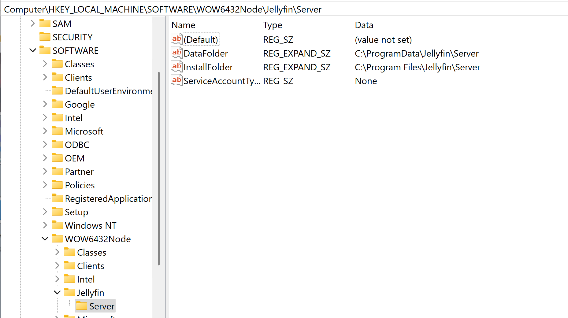

    Make sure your registry looks like this.
    • DataFolder must be the location where the application support files will go (database, config, logs, etc).
    • InstallFolder must be the location where jellyfin.exe can be found.
    • ServiceAccountType is "None" unless Jellyfin is installed as a service, in which case it will either be "LocalSystem" or "NetworkService".
