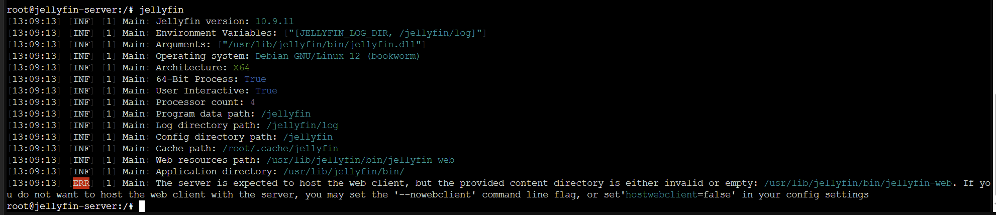

    but after the script finished I tried checking if the server is running using jellyfin command and it shows  this
    I tried looking for the directory but there's no jellyfin-web there
    i'm using Proxmox and Debian 12 container

    Jellyfin operates as a system service, so typing "jellyfin" in the terminal is not the correct way to start Jellyfin and will result in an error.
    To check the status, use the command:
    systemctl status jellyfin
    After installing with the script, you can configure Jellyfin in your browser at this address: http://localhost:8096/
    If Jellyfin isn't running, you can start it with:
    sudo systemctl start jellyfin

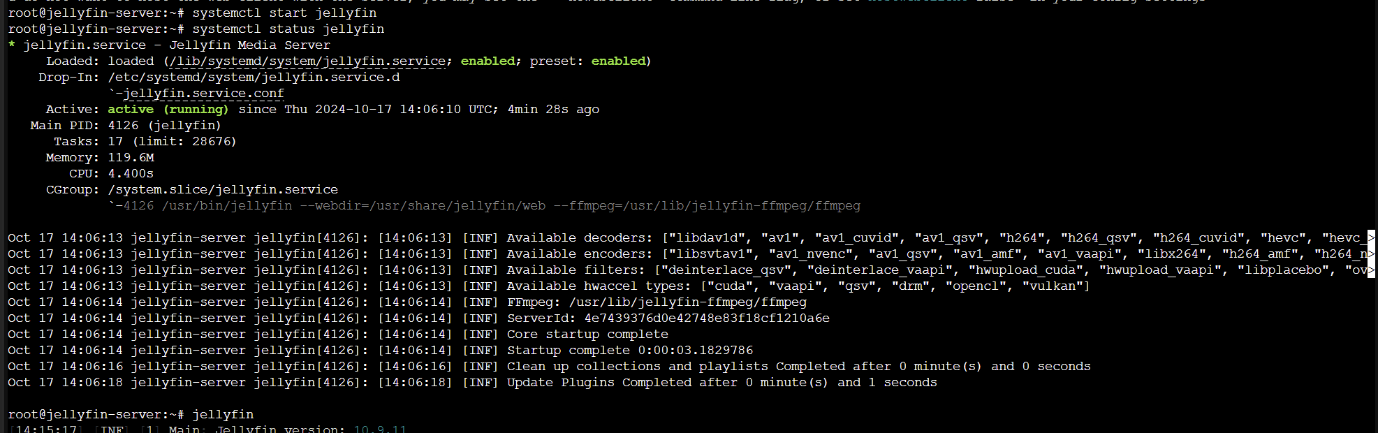

    Thanks for the reply
    I tried using systemctl and still can't connect to webgui

    From your screenshot, it looks like you’re still running "jellyfin" in the terminal. Once Jellyfin is installed and running as a service, you don’t need to interact with the terminal. You can simply configure it through your web browser at http://localhost:8096/.
