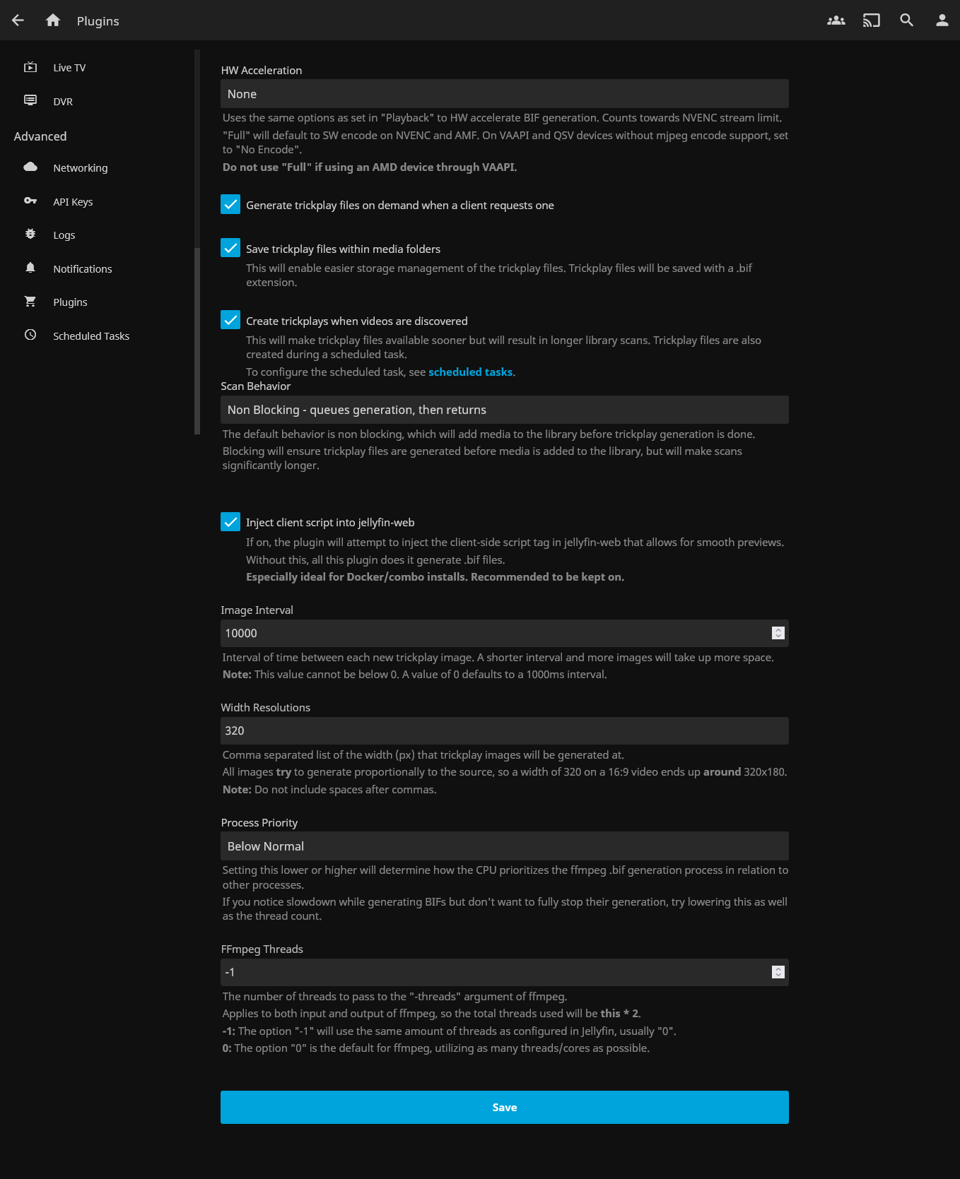

    this is how my settings look

    The Jellyscrub settings screenshot you provided indicates that you are not using Hardware Acceleration (HW Acceleration is set to none) that means your CPU will be used for generating the BIF. Depending on your CPU it can take from couple of minutes to couple of weeks for a single movie. I recommand using a GPU instead if one available.

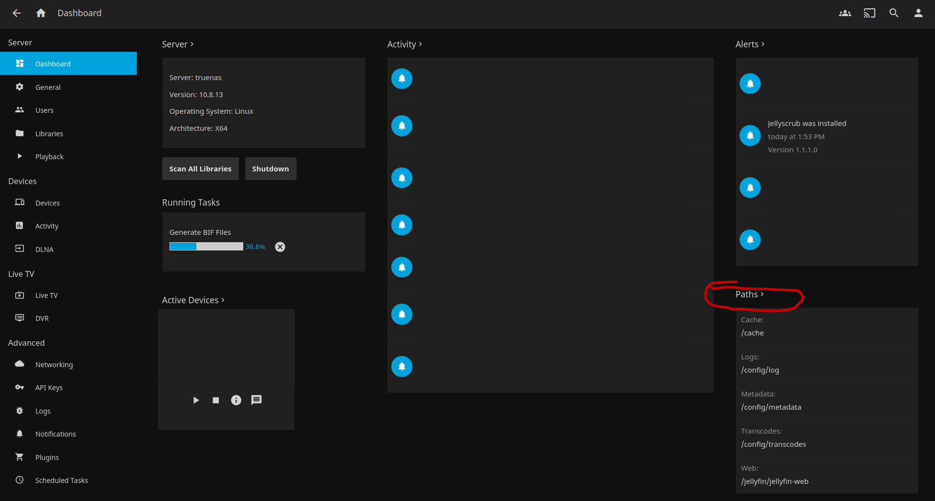

    I've been reading up on the web and looks like Jellyfin has 4 file pahts as listed under "Three vertical bars > Administration heading > Dashboard
    • I can see the following paths listed:
    • /cache
    • /config
    • /jellyfin/jellyfin-web
    Within Jellyfin Dashboard when I click on those file paths nothing happens. I think they are listed there as a reference and not a clickable link that would take you to that folder.
    I realize now that during setup I didn't map a "jellyfin" folder as the guide I was following didn't list it.

    Screenshot of Dashboard view showing the host paths:
    [Image: VQxBRm0.png]
    *Image uploaded via Imgur
    2024-01-25, 09:52 PM
    You don't HAVE to map a /jellyfin folder because in a typical setup the contents of that directory don't need to be permanent like they need to be for /config and /cache. But if you want to make a persistent change to index.html for jellyscrub you will need to create a permanent path for jellyfin-web.
    You can map it anywhere as long as the container can access it. By setting up a volume on the host machine you are making jellyfin-web permanent between shutdowns.

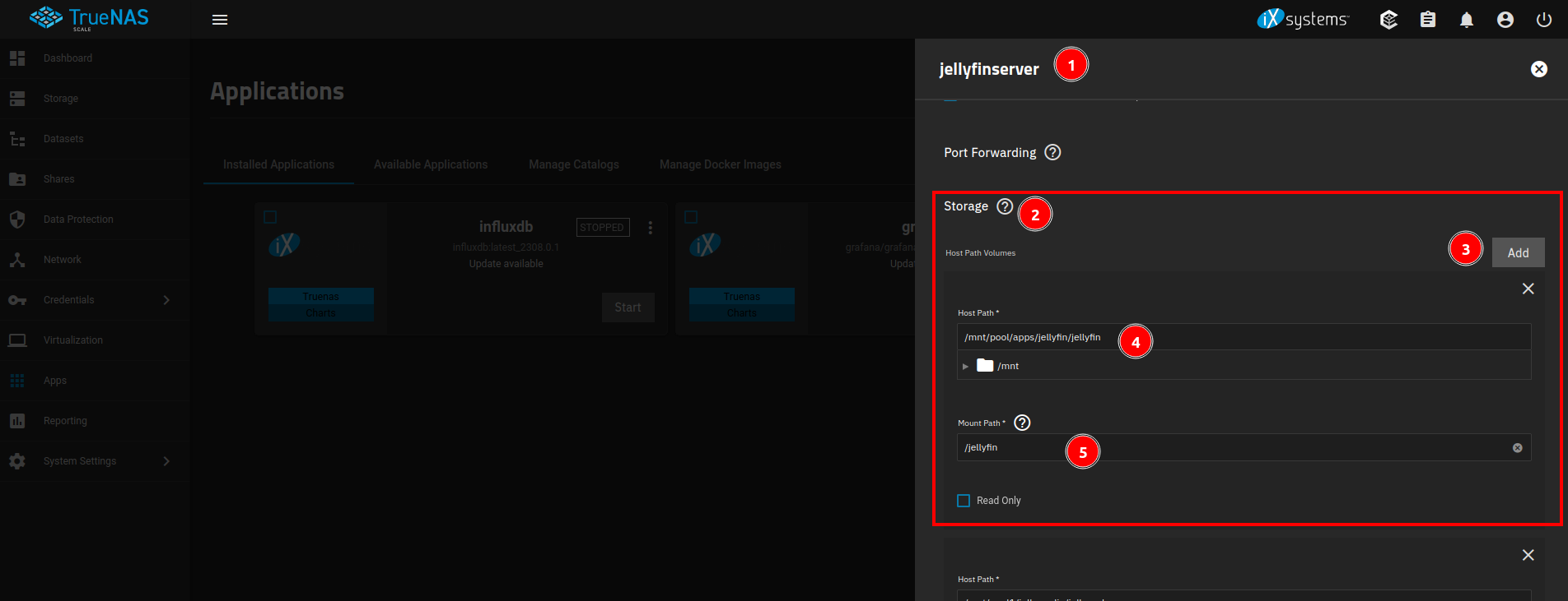

    To make sure I understand correctly:
    1. In my TrueNAS dataset create a folder called "jellyfin"
    2. Shutdown Jellyfin on TrueNAS
    3. In TrueNAS open the Jellyfin App to edit settings (TrueNAS > Apps > Jellyfin three dots > Edit)
    4.Add storage by mapping "host path" on TrueNAS to where it should be in Jellyfin as per screenshot:
    [Image: Dbp1bQk.png]
    5. Save and start Jellyfin service.
    This new mapping won't delete any of my other settings within Jellyfin? That's the part I'm worried about.
    2024-01-25, 10:44 PM
    That sounds right.
