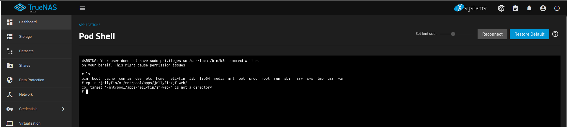

    • When I enter the Jellyfin shell (TrueNAS > Apps > Jellyfin three-dots > shell) from what I understand I'm in the shell of the container. Wouldn't that mean I can't copy files outside the container / pod ?
    • When I run the command cp -r /jellyfin/* /mnt/pool/apps/jellyfin/jf-web I get an error that directory doesn't exist
    • I tried mapping an SMB share within the pod but because there is no sudo I can't mount to an external folder.
    The next hurdle to overcome: How would I go about copying the contents of /jellyfin/* out of the container?
    This is the text I get when I open Jellfyfin shell: WARNING: Your user does not have sudo privileges so /usr/local/bin/k3s command will run on your behalf. This might cause permission issues.
    Screenshot of shell in case it helps:

    Now to explain what you're doing wrong with the screenshot.
    First, the issue with the sudo privileges warning is that the user running the container is not root. If you configure the app to launch with root access, logging into the shell will not show this.
    I'll go over how to give it root access a bit later. I wouldn't try mounting anything in here just to keep things simple.
    Second, you are in the shell of the app's container. As in, you're in what the container believes to be the whole system. It doesn't have access to the outside Truenas system.
    The point of containerization is to cut off access to services from the rest of your system.
    Therefore, when you tell it to copy jellyin/ into that path, it doesn't exist under that name.
    Basically, the container running Jellyfin is presenting that whole path as just "jellyfin/jf-web" since that is how you mounted it.
    So the correct command to copy everything from that folder would be: "cp -r jellyfin/* jellyfin/jf-web/" (There's an issue with this).
    Now this is why I stated to remove the previous host mount you did. The blank host mount should be anything but linked to the name "jellyfin/".
    You basically don't have the files if that's the case.
    I will say that you should probably change the folder name for this mount path. You'll be copying everything in jellyfin/ into jf-web, which doesn't make sense with what we're trying to do.
    However, this shouldn't be an issue as long as you mount "/mnt/pool/apps/jellyfin/jf-web" as "/jellyfin" in the container host path volume settings.
