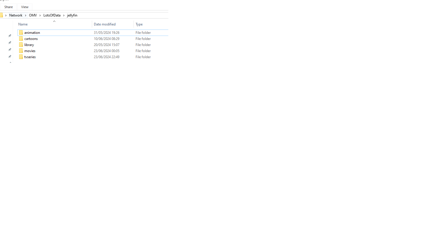

    I assume that JF installed on the RPi SD card, but would like to check as the following directories are located on my my NAS (that uses hard drives):
    OMV>LotsOfData>Jellyfin>library/movies/tvseries.
    The  library,movies,tvseries folders were already there once JF was installed. I have been copying my media to the mentioned movies and tvseries folders.
    I am not sure if the library folder should be located on the OS SD, rather than on the NAS hard drive, or I am doing something else wrong.
