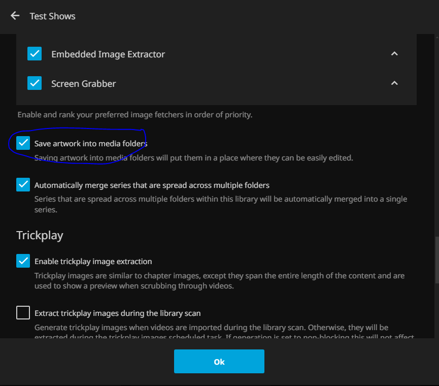

    So had some progress today. Re-installed JF folder on the SD card. And after initial crashes unticked the option in Library settings to "Save artwork into media folders". Now when navigating in the JF menus it does not crash at all. Yay! And it seems to store the media image files on the SD.

    NFOs are always stored in the same folder as the media.  Images CAN be stored with the media if you check the box.
    You can try enabling that so the images aren't saved on the SD card.  Is it possible the SD card is bad or something?  Bad sectors?
