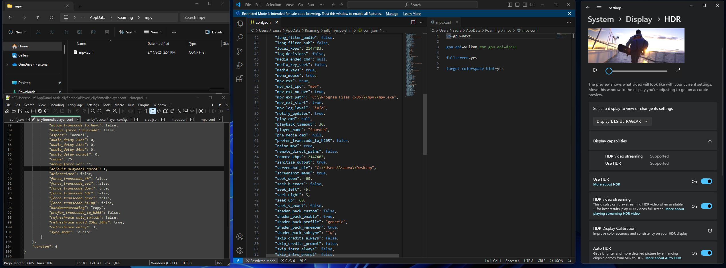

    Ah, I see. I do use for MPV player for HDR10 and DoVi, but not sure how it process the media. Read my previous post about it. I have also attached a screenshot of the config I used for MPV. I also have MPC-BE with madVR & LAVFilters but DoVi doesn't work on it.

    I installed Jellyfin MPV Shim and did the configuration that was mentioned in this post
    1. I can play all formats on MPV Shim.

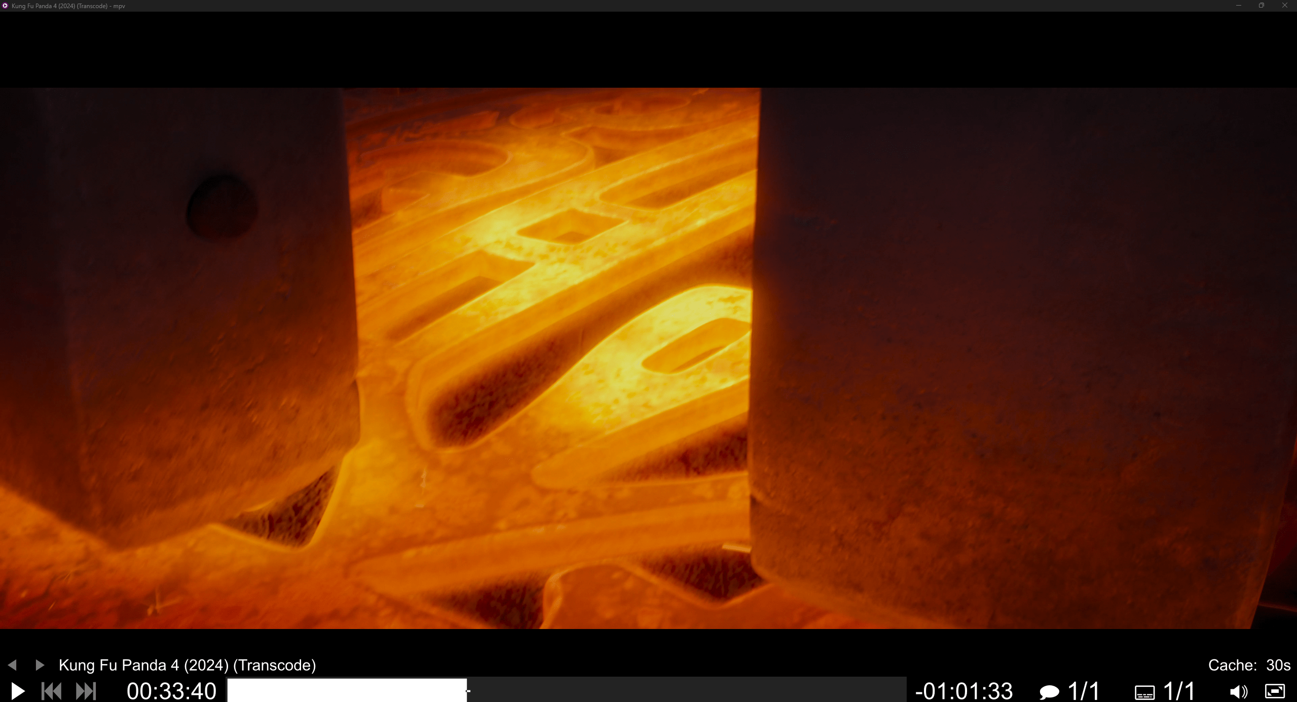

    2. When I cast videos using MPV Shim they are very stuttery, but when I use mpv.exe directly there is no stuttering or lag.

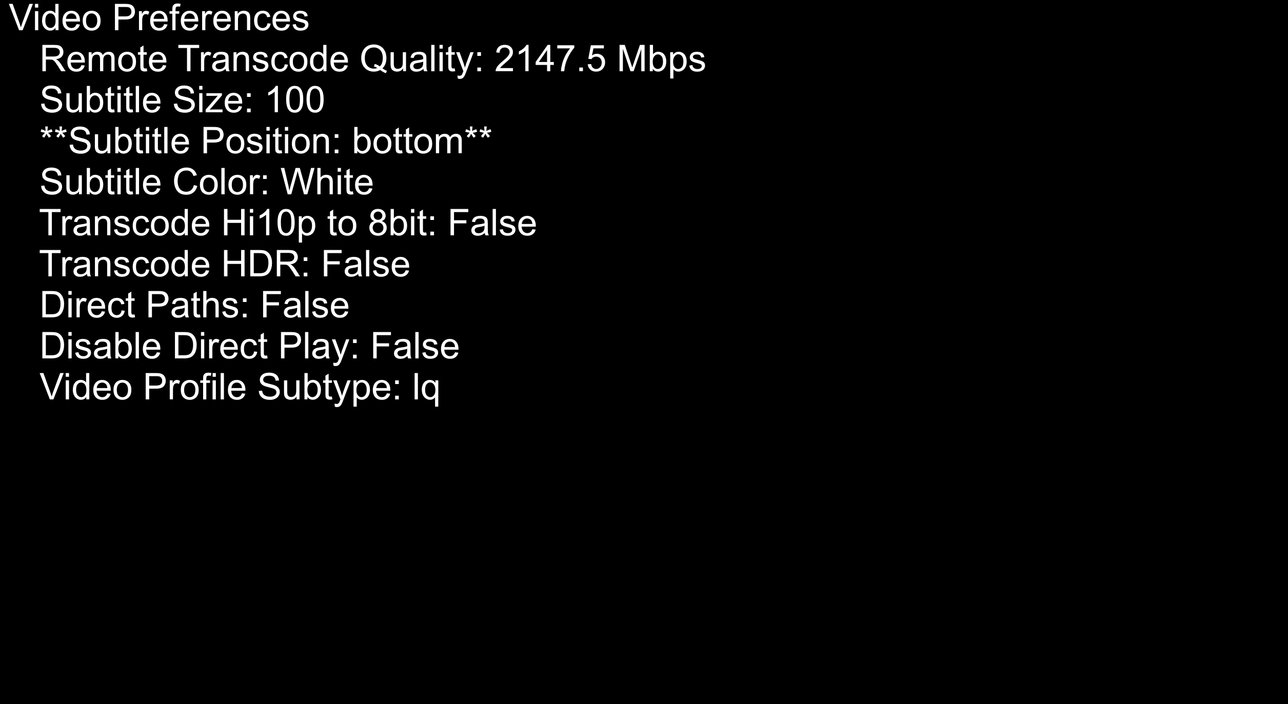

    I disabled the transcoding in Jellyfin MPV Shim by right clicking on the taskbar tray icon, and then selecting "application menu" but it still caching and transcoding.
    Here are some videos of the issue
    mpv: https://streamable.com/78qkx7
    jellyfin shim cast: https://streamable.com/woucij
    What could be causing the stutter?
