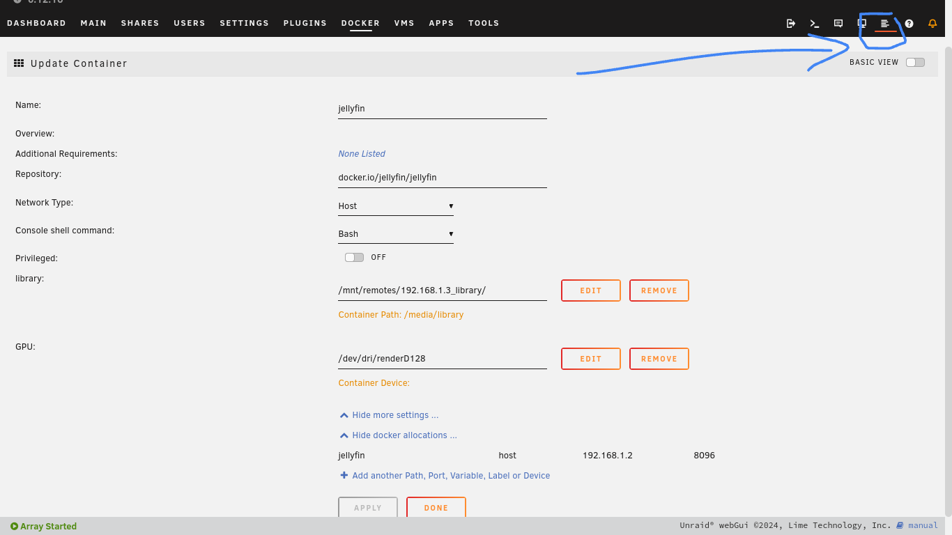

    I've tried to add a "--memory: 20g" flag to limit RAM usage, but it did nothing. It keeps climbing to 90 percent, before I manually stop the docker.
    What is the correct way to solve this?

    My system has 32 GB of RAM. It is indeed because Jellyfin is in the process of adding my entire library, so it launches a lot of ffmpeg probes this ends up consuming all my memory.
    I tried limiting the container to 20 gb of memory with the enviroment variable "--memory=20g" (maybe it is not correct?). This did not work.
    2024-08-04, 07:27 PM
    You can also limit the number of library scan threads in Dashboard > General: Parallel library scan tasks limit and Parallel image encoding limit
