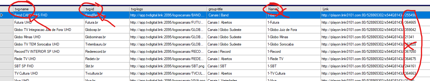

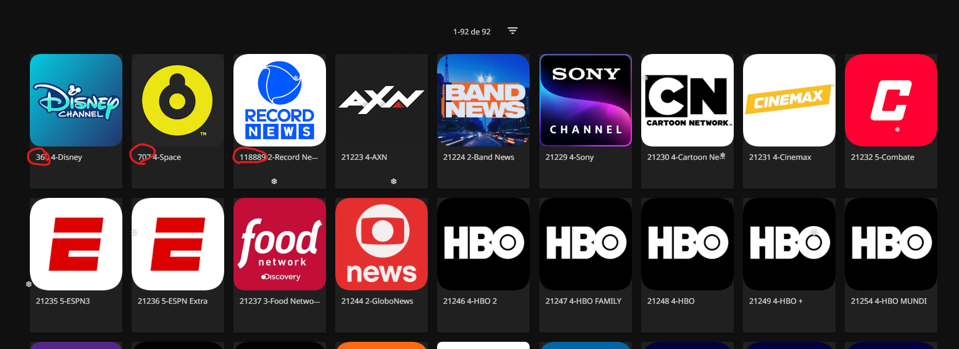

    As you can see in the screenshot, the organization of channels is based on a number that is part of the link path. I would like the list to be sorted by tvg-name or tvg-id so that I can use indexes 1,2 3..... to decide which appears first
    I already tried reading the HTML and JS files in search of something that I could edit/change but I didn't find it, I also looked for custom css that could help, but I didn't find anything. I'm very noob with coding, so if anyone can help I'll be grateful.

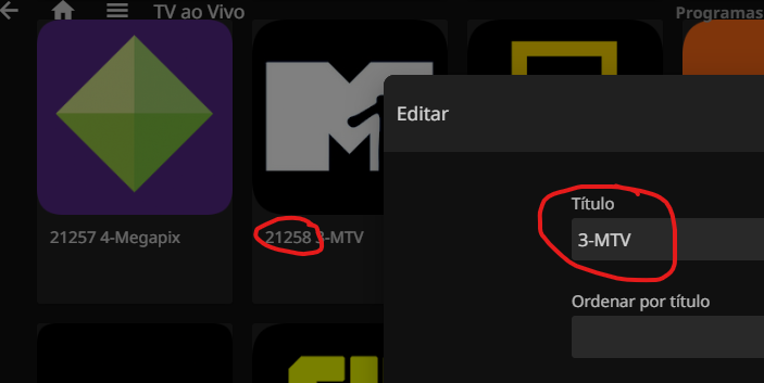

    2024-07-08, 07:51 PM
    (2024-07-08, 02:27 AM)theguymadmax Wrote: Not sure if this is what you are looking for or if there is a better way. If you hover the mouse over the channel icon a kabab menu will appear. Once you click on it, select edit metadata. You can then input a custom sort title.
    I've already tried this method, but as you can see in the screenshot, still diferent!
    2024-07-08, 07:55 PM (This post was last modified: 2024-07-08, 07:55 PM by TheDreadPirate.)
    The sorting title is not displayed. It is only used for behind the scenes sorting purposes.

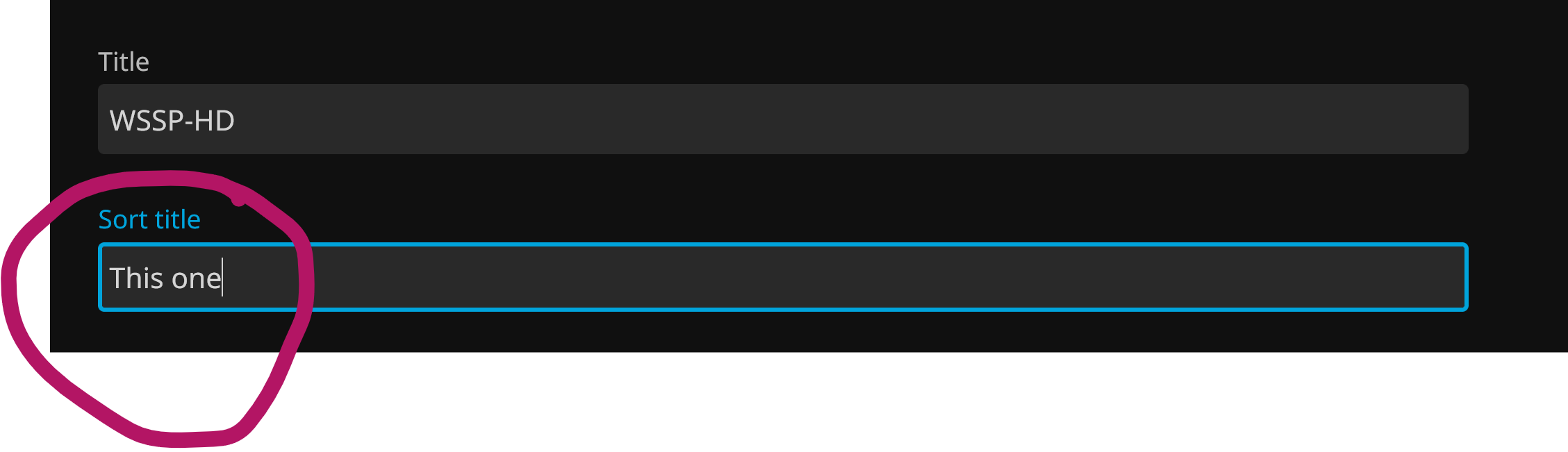

    2024-07-08, 08:08 PM (This post was last modified: 2024-07-08, 08:16 PM by theguymadmax. Edited 1 time in total.)
    You are editing the wrong field. See my screenshot. Use "Ordenar por titulo"
