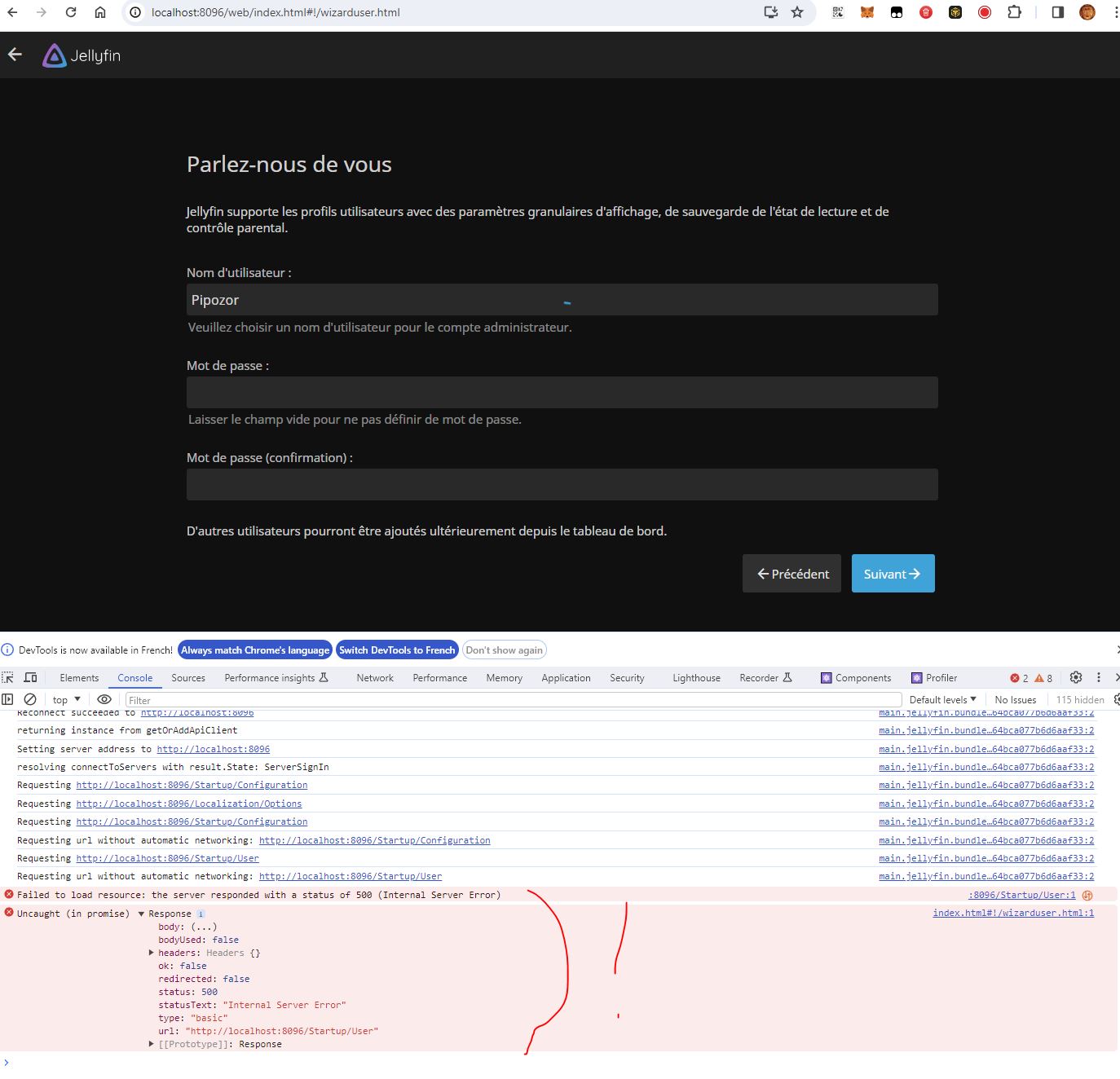

    2023-12-26, 07:45 PM
    I uninstalled and re-installed but still locked in the wizard screen. I think there is an error, please see screenshot.
    Jellyfin 10.8.13
    Windows 10 Professionnal

    2023-12-27, 10:27 AM
    I did reinstall in administrator mode. Same issue.
    In fact the 500 Server Error, stopped the process.
    Is there a way to know which jellyfin.db is used? Because I got one in ProgramData and one in Users.

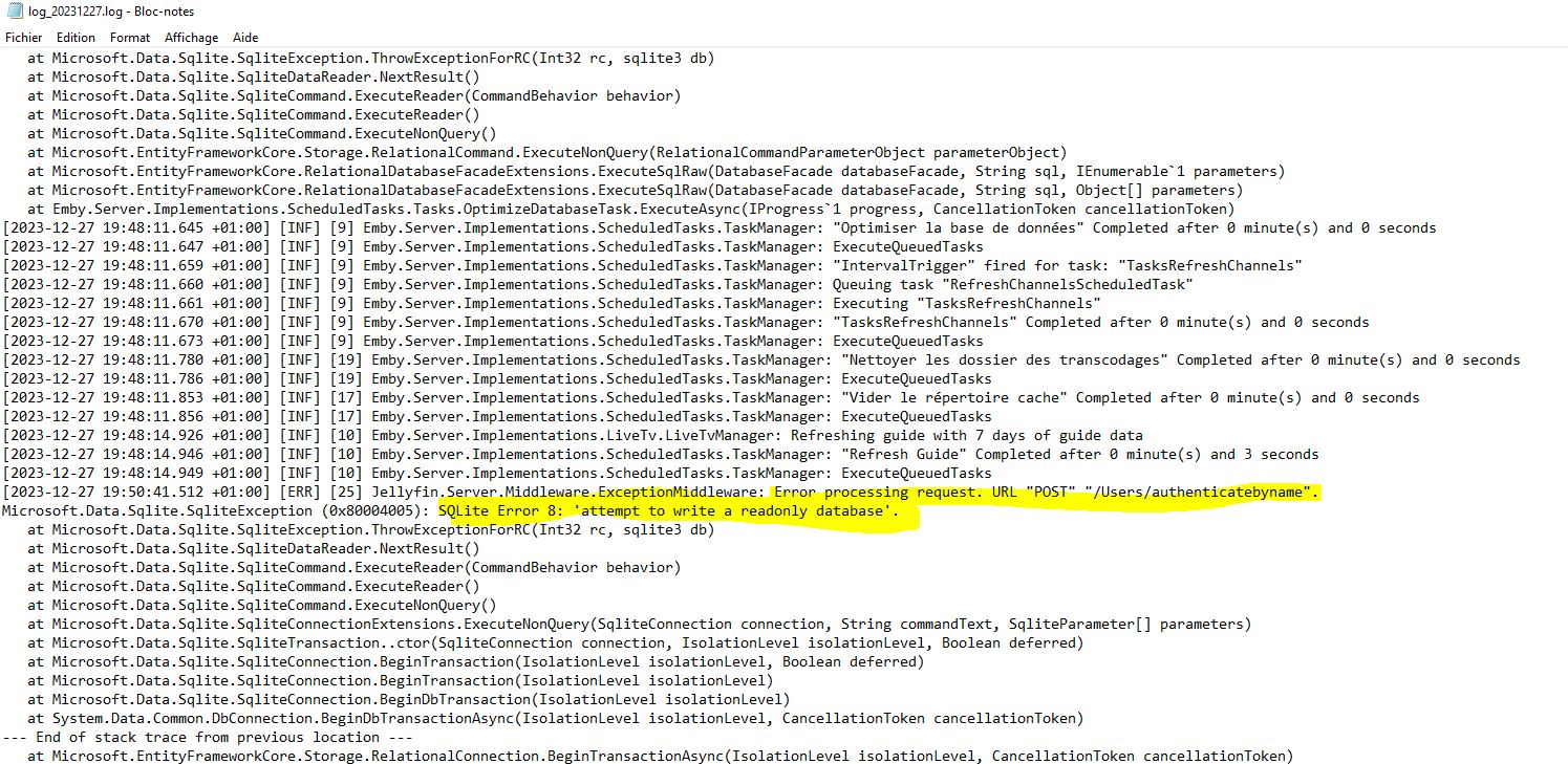

    #26
    2023-12-27, 06:52 PM (This post was last modified: 2023-12-27, 07:08 PM by pipozor. Edited 2 times in total.)
    Found this error (see screenshot)
    And this is why I got Error 500 in web request.
    I do not know how to fix this Slightly-frowning-face

    Posts: 11,848
    #27
    2023-12-27, 07:35 PM (This post was last modified: 2023-12-27, 07:35 PM by TheDreadPirate.)
    Stop jellyfin, if it is running. In C:\ProgramData\Jellyfin\Server\data (I think that is right for Windows) delete any *.db-shm, *.db.wal, or *.db-journal files. This usually happens when Jellyfin is not shut down cleanly.
    MAKE A BACKUP BEFORE DOING THIS

    #28
    2023-12-28, 09:25 AM
    O.M.f.G. !!!!!!!!!!
    That was that. Thank you so much, all back to normal now.
