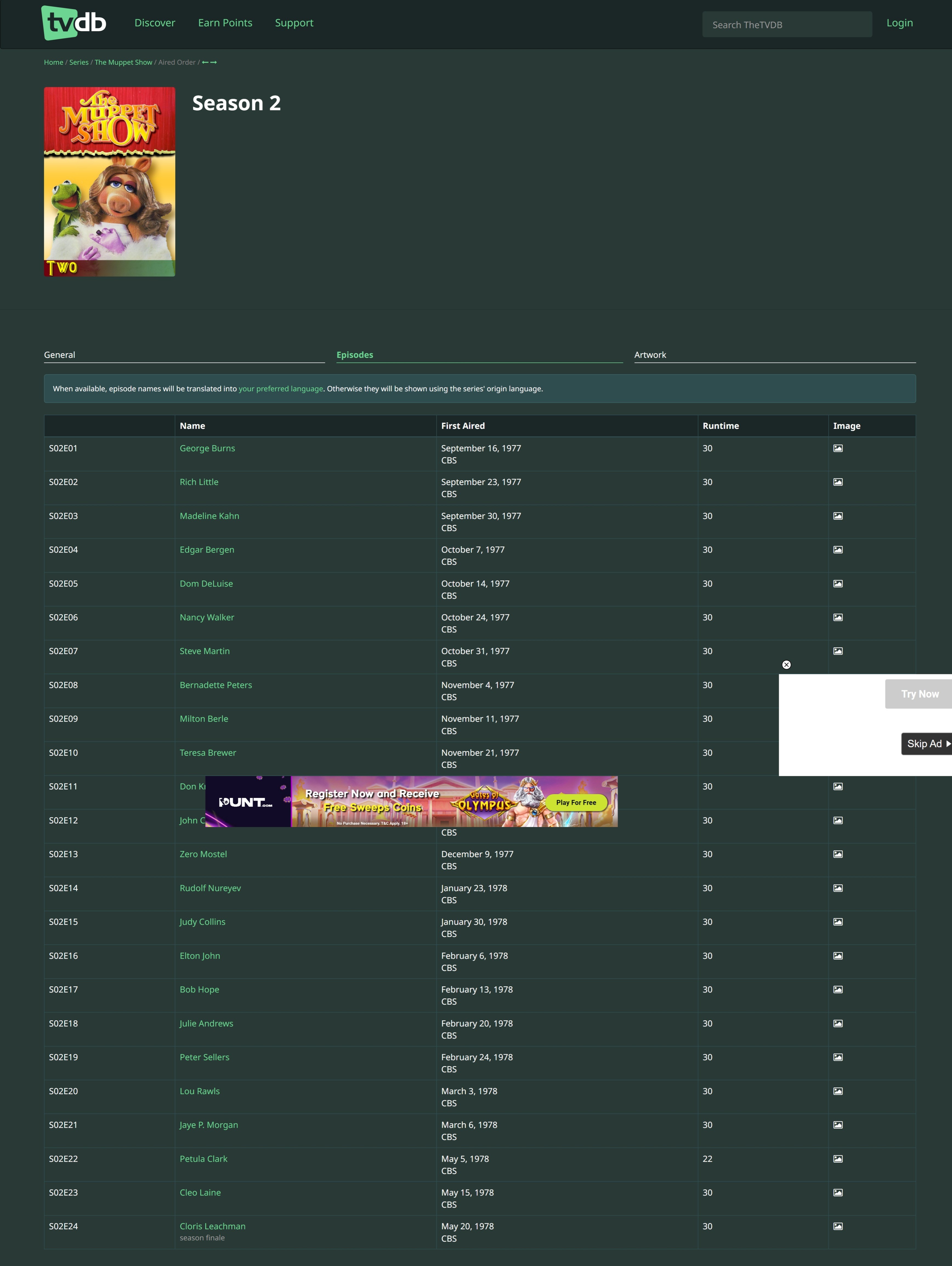

    This is the order they were aired:

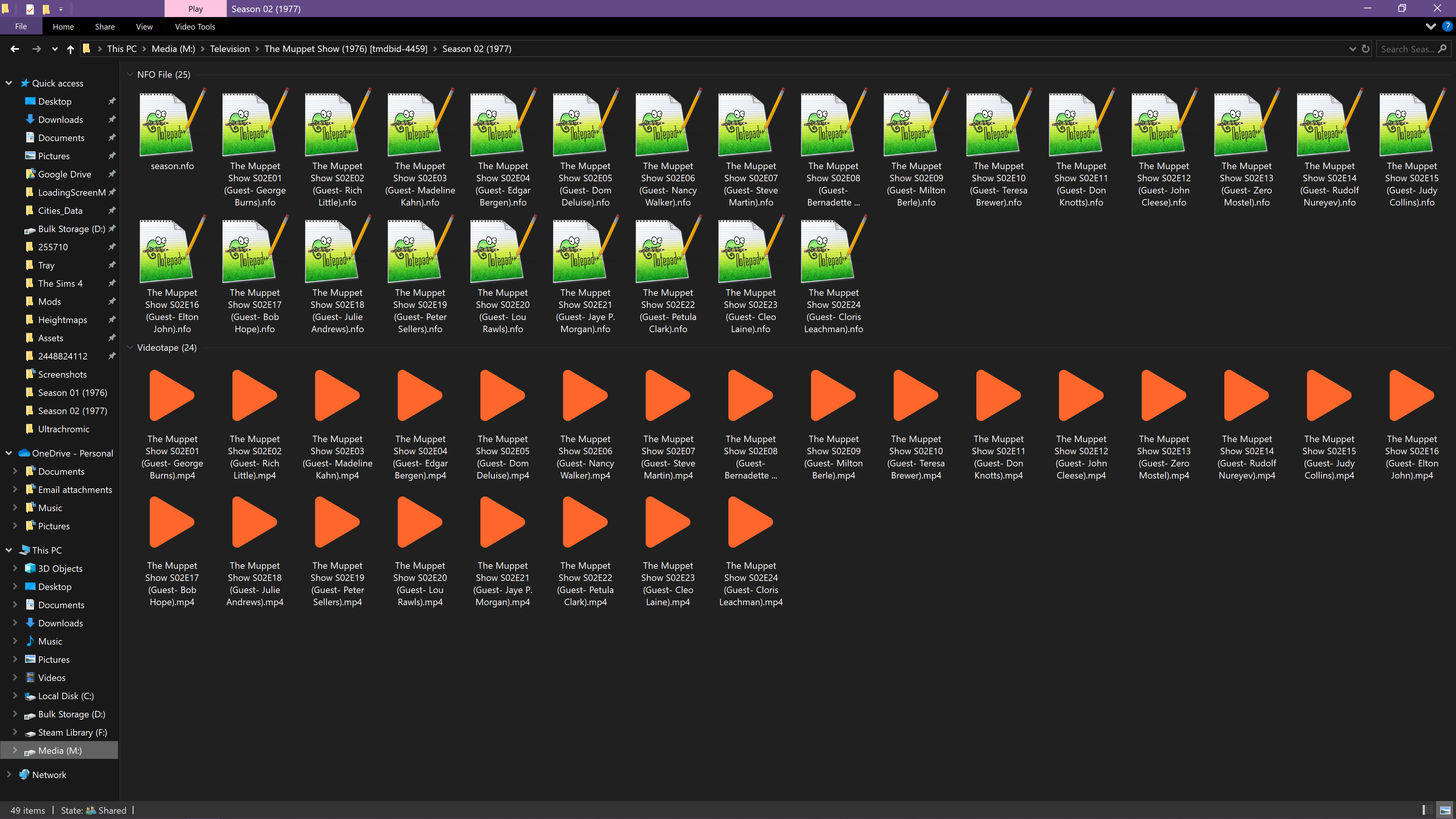

    And this is how everything is named:

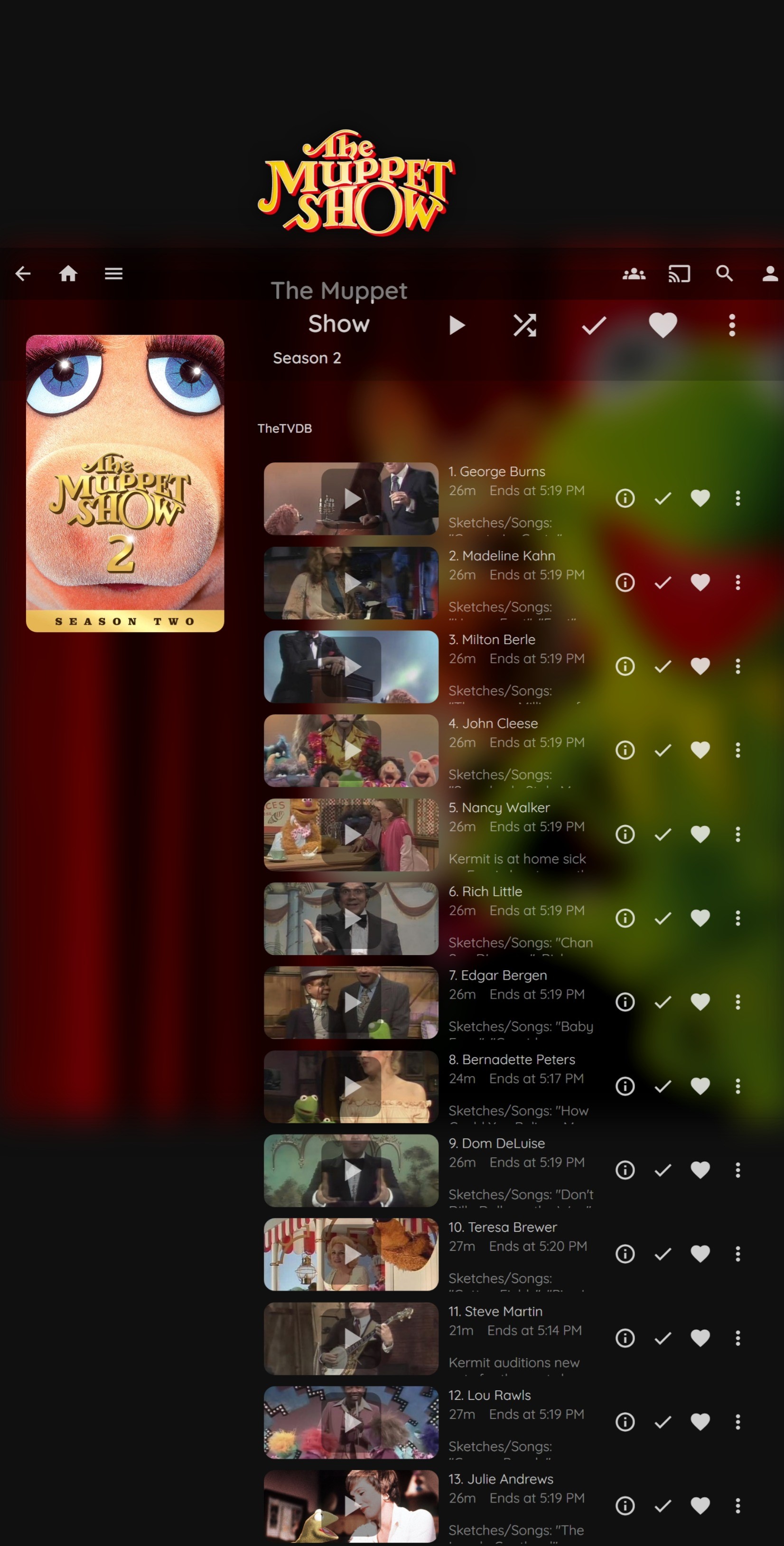

    But this is how it shows up in the player:
    And when I click on an episode, it plays the correct video instead of the one suggested by the thumbnail and description. Playing "2. Madeline Kahn" starts the Rich Little episode, which is the correct video.
    The nfo is clearly confused. I deleted the existing ones, made sure it was set to "Aired", and refreshed it. But it still gets the info wrong. That isn't even the right aired date for episode 2.
