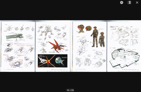

    Alrighty, I've tried it - it definitely works in the sense that it does allow me to display this content as Books, and I quite like how this media type has the option to display two pages/images at the same time during reading ; but in actual practice, having to prepare CBZs for all books and folders + the lack of a grid overview showing all pages/images (not needed for regular books, but quite important for artbooks) makes it an inferior solution to the Photo Library approach.
    I am therefore back to square one Grinning-face (this was an excellent suggestion though).
    Is it possible to split the Library list in two or more lines (as per my mockup), with Custom CSS perhaps ?
    Also and FWIW, here's a bug for Double Page View : left page appears under right page when zoomed in.
