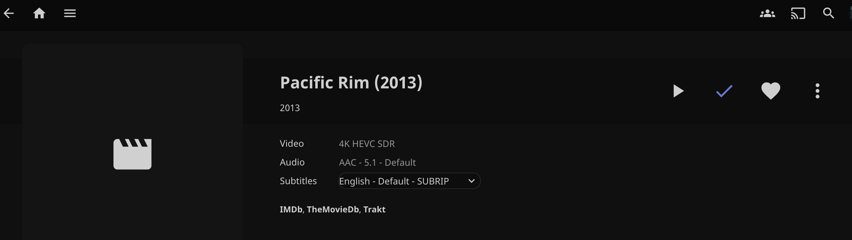

    I noticed recently after I tried to add Pacific Rim to my Jellyfin Server, my server wouldn't grab the metadata for it in any capacity. I even got Radarr to produce .nfo files to help jellyfin come up with some sort of metadata, but nothing would come up either way. If I run an 'identify' search on the movie with IMDb, TMDB, or the movie name, it sits and spins for 10+ minutes before returning nothing. I tried running a full library scan, and it seems to be going very slowly, so after checking the logs, I was seeing a lot of 'slow response' or 'response timeout' from various services. I saw could not connect to TMDB, and slow responses from opensubtitles. I will attach the log file below.
