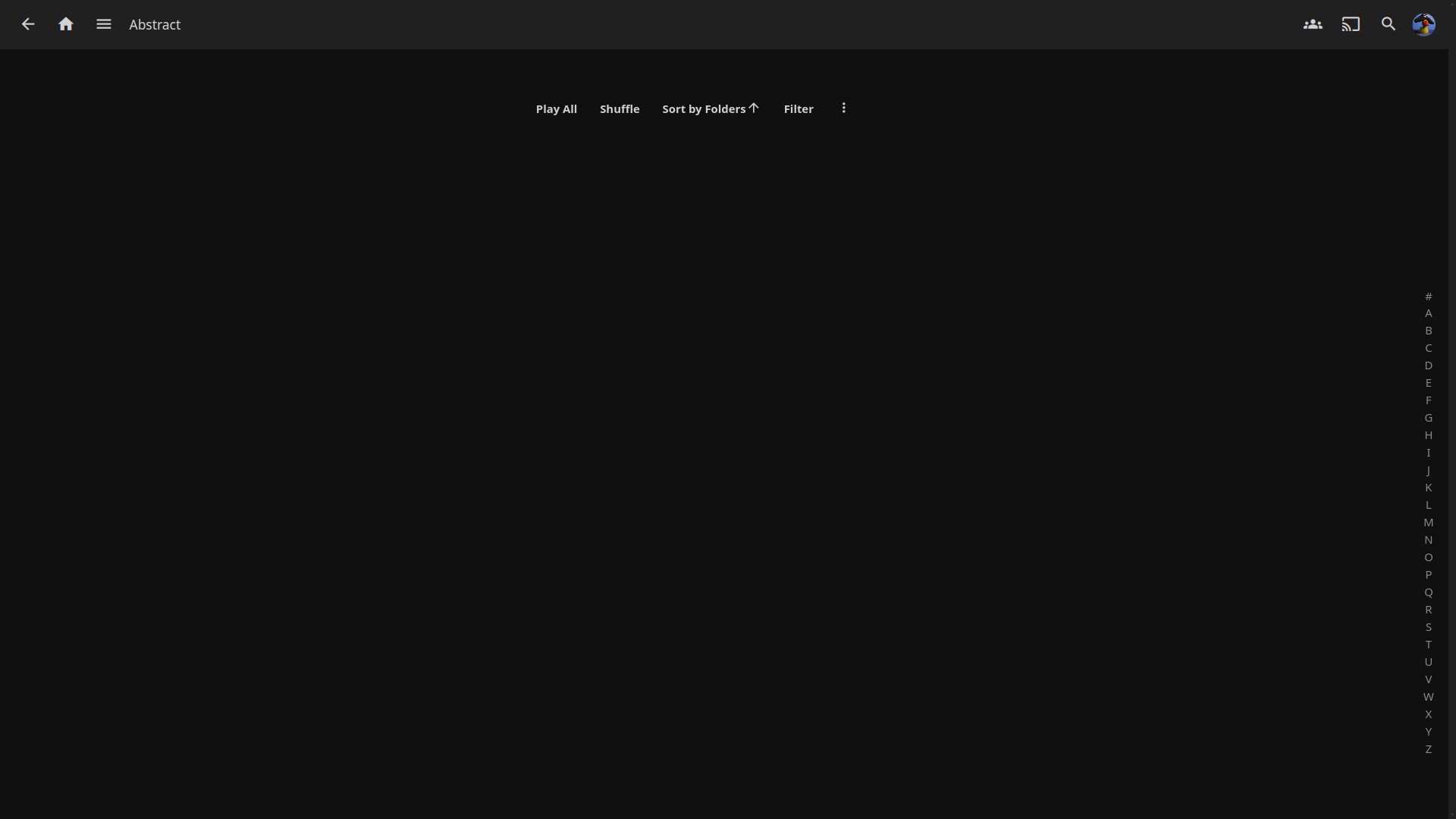

    AFAICT, the ones that are missing in Symfonium are empty genres.  Not sure why there is a genre if there aren't any songs to go in them, though.  Which means this IS a Jellyfin problem.  Here is a screenshot of mine.  "Abstract" is present in the web browser, but is clearly empty.  I'm guessing Symfonium just drops the genre.
