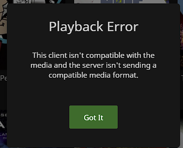

    Now the problem is that I now get the message "This client isn't compatible with the media and the server isn't sending a compatible media format.".
    A look at the log file showed me that there is obviously a problem with ffmpeg.

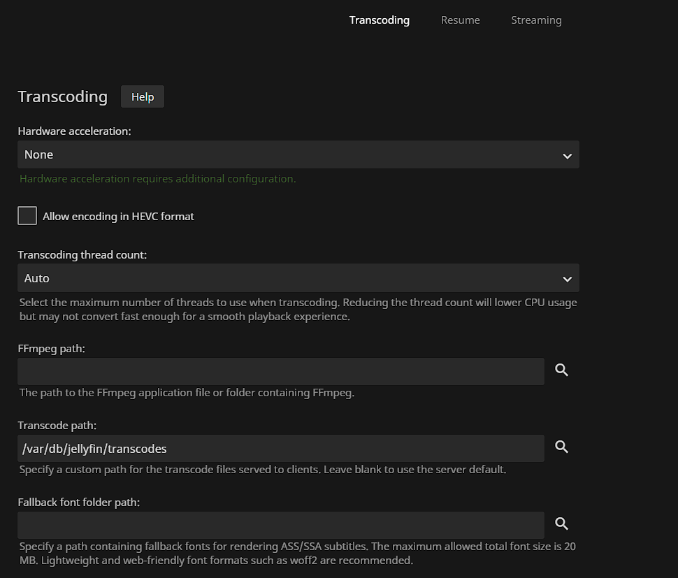

    So I took a look at the playback settings and saw that the ffmpeg path was not set.

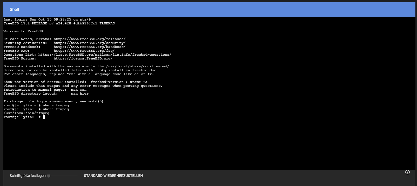

    I went back to the jail shell and tried to reinstall ffmpeg, but I'm not a pro at dealing with this stuff.
    What I could do is to update the whole package again (including ffmpeg).
    I think the path to ffmpeg should be "/usr/local/bin/ffmpeg" (that's what I get as a result when I type "where ffmpeg").

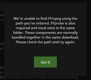

    But when I try that, I get another error message that says "We're unable to find FFmpeg using the path you've entered. FFprobe is also required and must exist in the same folder. These components are normally bundled together in the same download. Please check the path and try again."
    I'm a little confused that "/usr/local/bin/ffmpeg" appears to be a file, not a folder, as far as I can tell.

    You might have trouble finding help because TrueNAS CORE is not an officially supported platform. I'm assuming you are using some sort of community created Jellyfin image for TrueNAS Core. And that may not include ffmpeg. The official docker image has ffmpeg bundled and does not require additional configuration.
    What you COULD do is install ffmpeg directly in the host OS and then configure your jail to pass in the path to ffmpeg. Then set Jellyfin to use that path.
