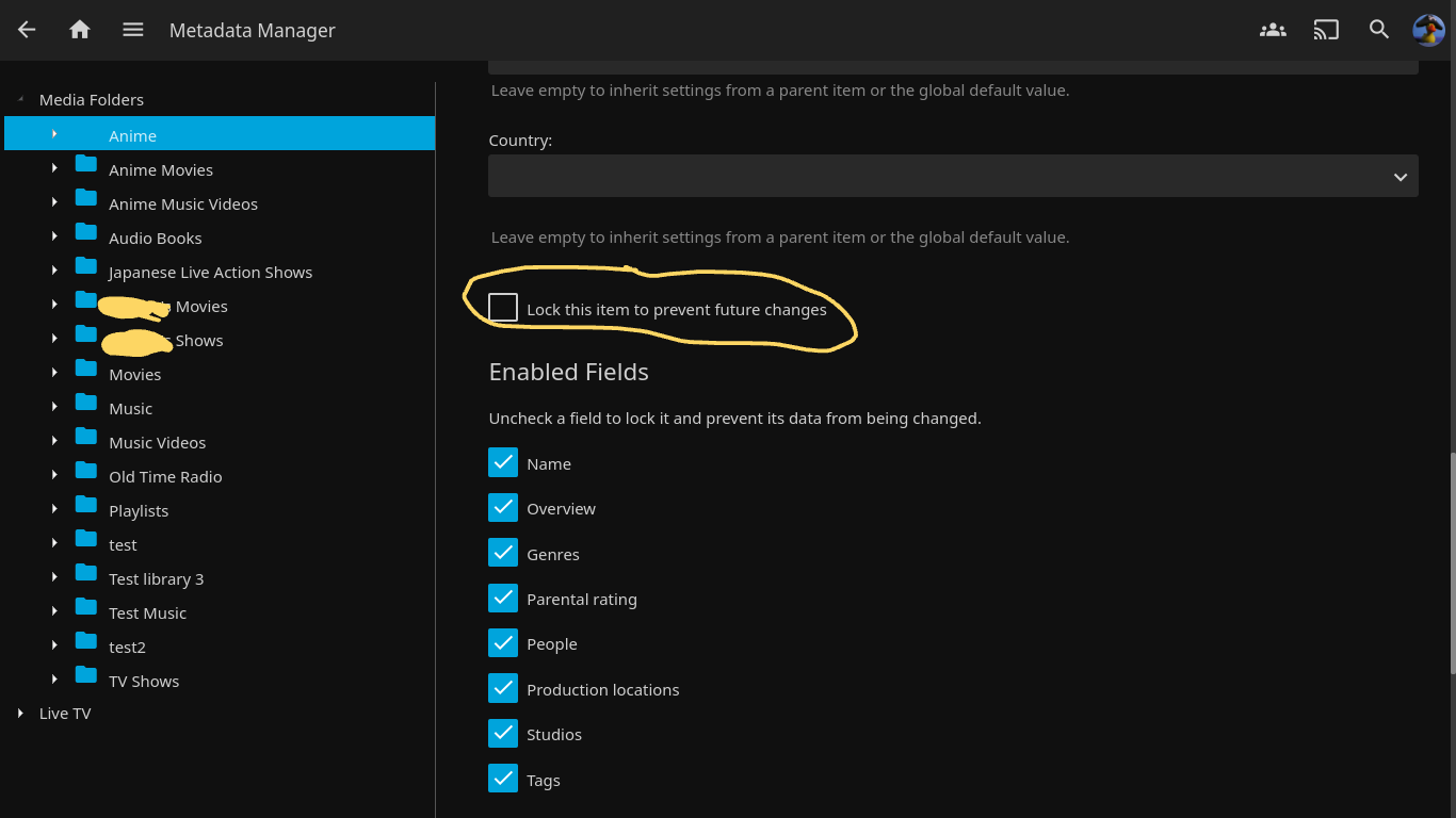

    Local metadata always takes precedence by design.  If, for some reason, you aren't able to or don't want to delete the images you can try locking the metadata.  You can do this per show or for the whole library.  For locking metadata per show you click on the "..." context menu and "Edit Metadata".  Near the bottom is a check box to lock the metadata.  For locking the metadata of the whole library you need to use the metadata editor just below the option to go into the dashboard.
