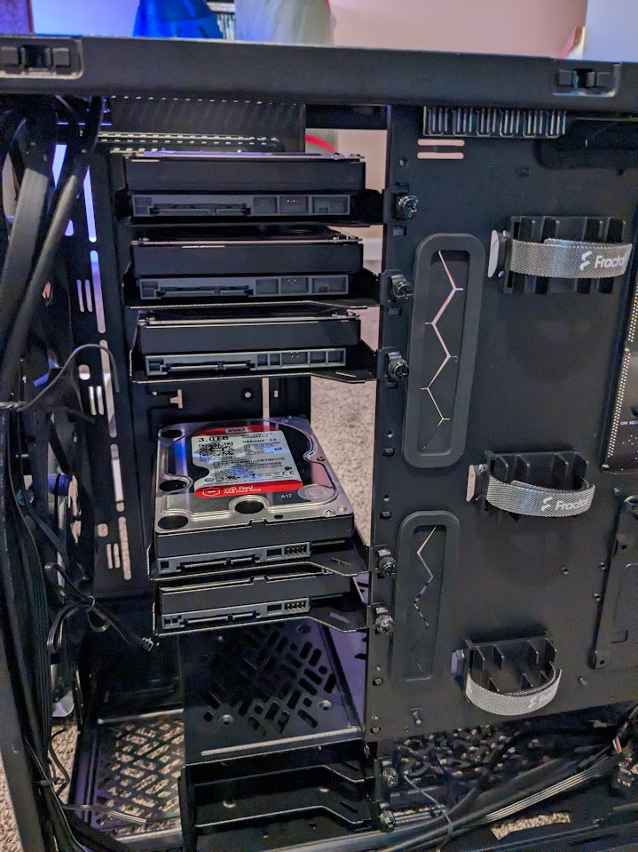

    My much more tame setup in a Meshify 2.
