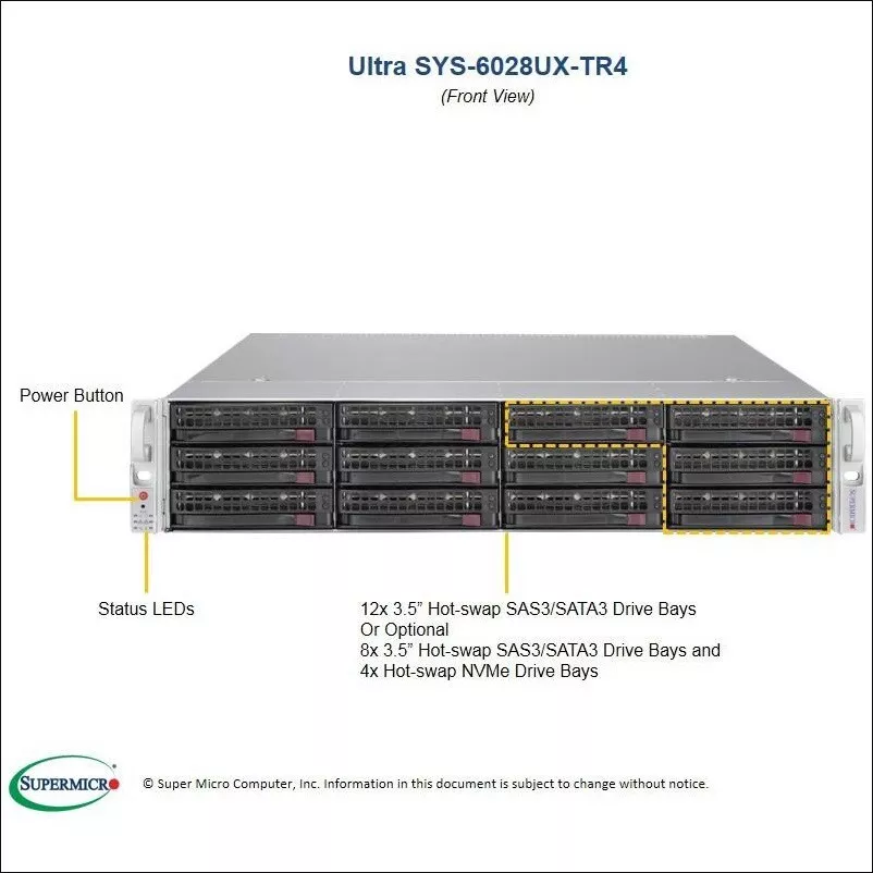

    You might want to take a peak into those refurbished servers on ebay.  Some come configured for TrueNAS or UnRAID if you're not looking for a full blown Windows or Linux box.  You don't need to spend $1000 either.  For instance, here's a dual XEON server with 128GB RAM, 12 hot-swappable drive bays...just gotta add your own hard drives.  I don't know if this is a good config or good price I just wanted to share something with you, give you something else to think about.
    https://www.ebay.com/itm/135016153556?_n...BMgPu2z65k
    [Image: s-l1600.webp]
