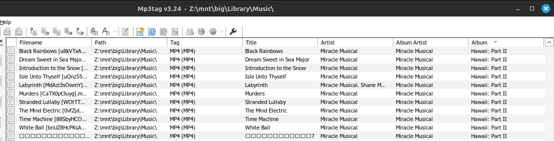

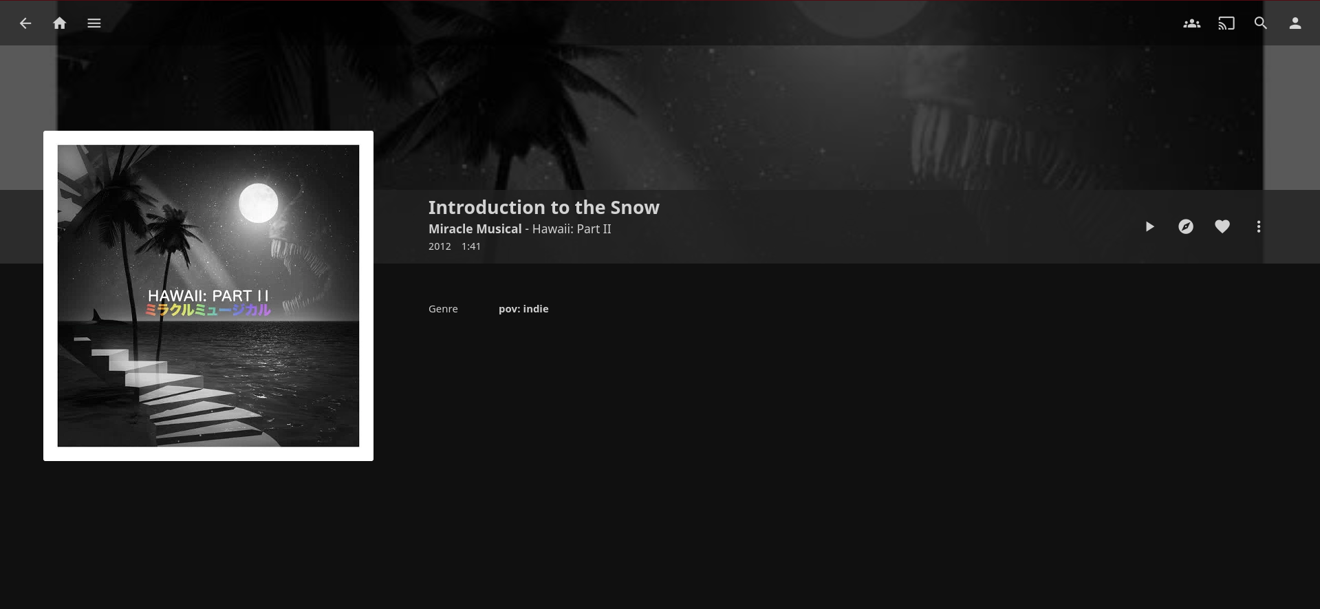

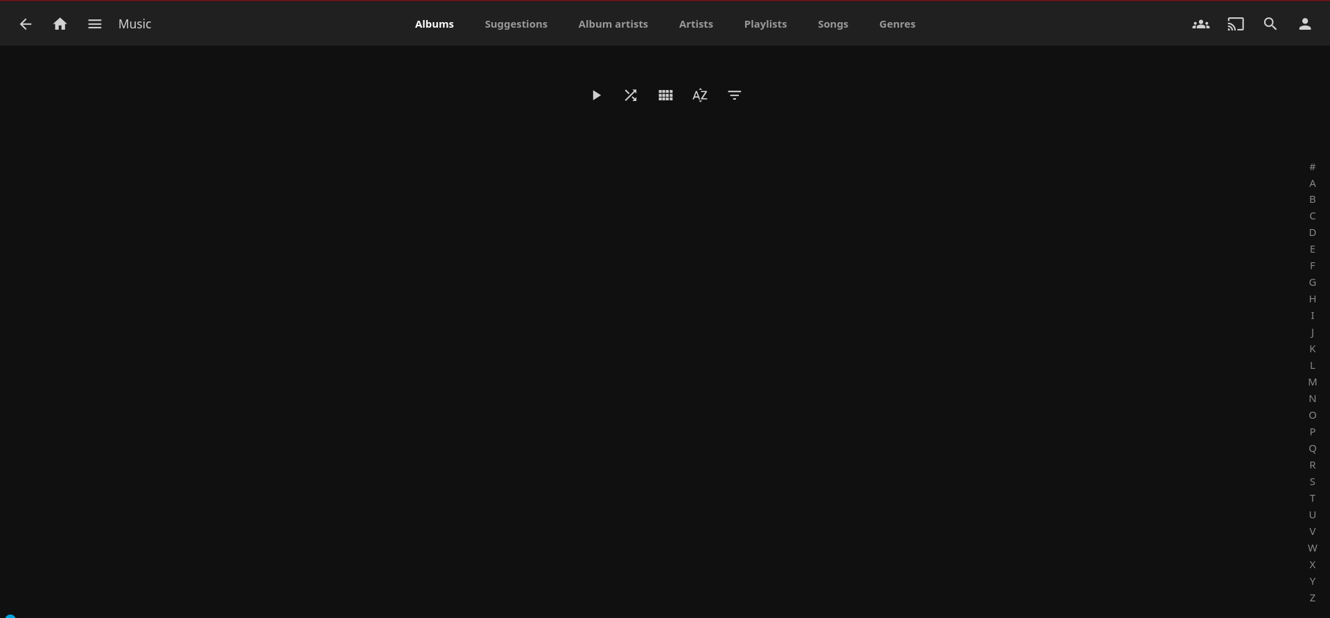

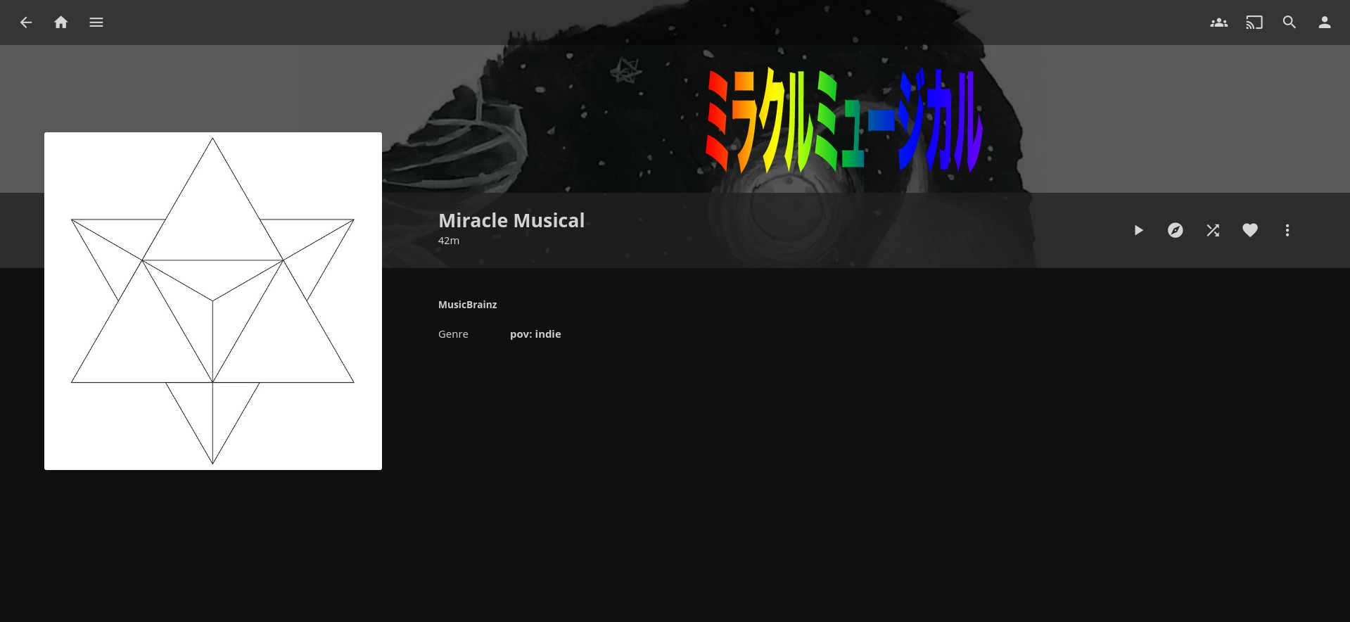

    Im having an issue where, despite all my music files being properly tagged, Jellyfin will not display any albums in the albums tab, as well as not displaying tracks or albums under artist pages. The thing thats especially strange to me is that the albums are listed when clicking on specific songs, meaning that at some level they are being detected.

    Music is a mix of .mp3 and .m4a files, all with metadata tags, and no directory structure
    Below are some attachments displaying my problems. Please let me know if there is any other information I can provide that would be useful

    FIle permissions look fine. Jellyfin can see all my songs individually, just wont group them.
    I would like to avoid restructuring my music folder around Jellyfins formatting if possible. Though if thats the only option until proper loose file support is added then I guess thats just how it is. Could maybe do with a correction on the documentation though.
