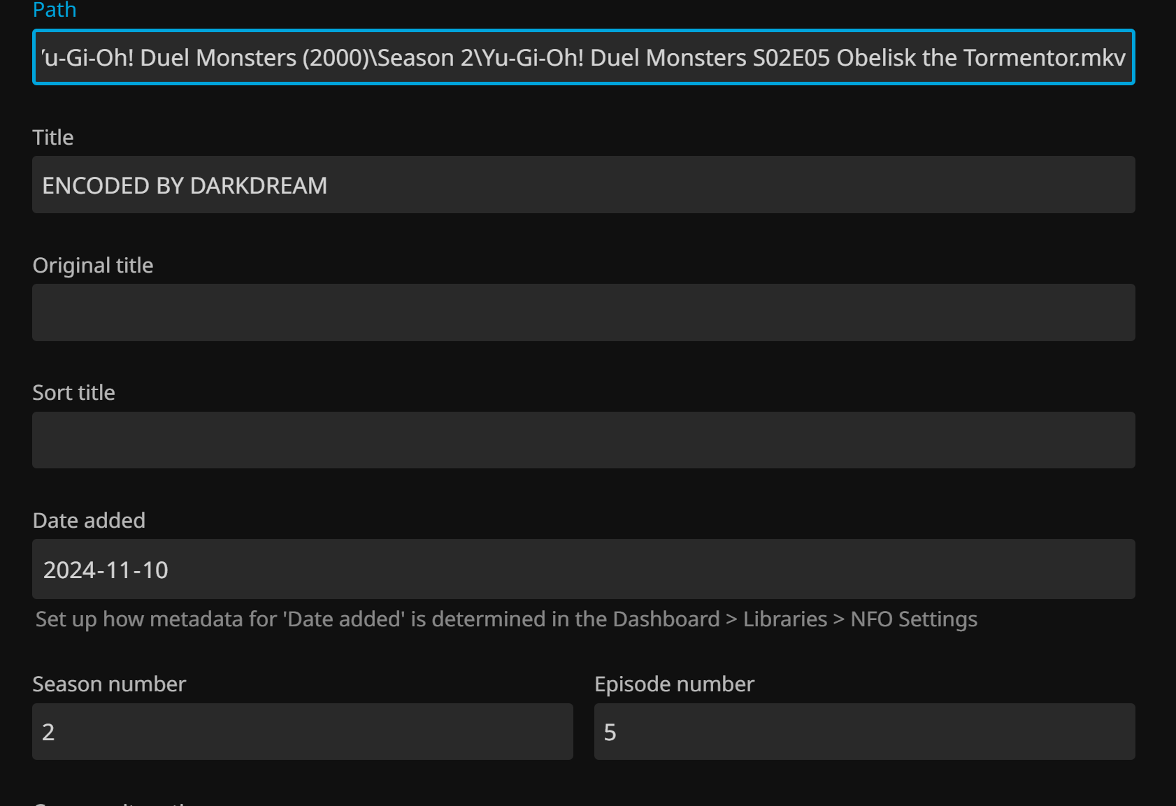

    I'm pretty new to Jellyfin and have been loving it so far, but I've run into some issues with series metadata and naming. I used Sonarr to rename the episodes to the correct format: (seris name) S01E02 (episode name), but I'm having touble with it populating for most of my series. For south park I get random episodes that got their name changed to a soccer/football series, and for yugioh all my episode titles are encoded by darkdream - which I can't find anything by darkdream in the file's properties. Does anyone have some advice on how to fix this? I would love to find out where I'm going wrong Here are some photos of the file names and and such:

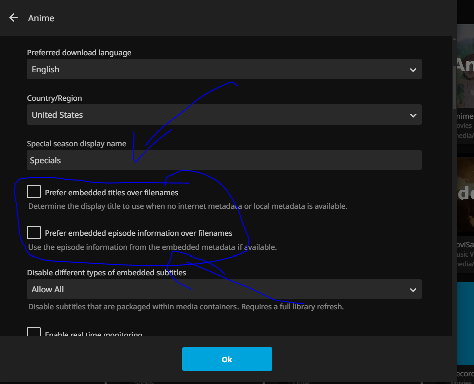

    2024-11-19, 01:39 PM (This post was last modified: 2024-11-19, 01:40 PM by TheDreadPirate. Edited 1 time in total.)
    Did you check one or both of these two boxes in the library settings? And which folder is the library "root"? The entire D drive? Or D:\TV Shows\?

    Q: Did you check one or both of these two boxes in the library settings?
    A: i did check both of those boxes, I re setup it, it fixed some of them, specifically the yugioh encoded by darkdream, but some of the South Park episodes are still showing the Chelsea football documentary.

    2024-11-19, 07:33 PM
    The two boxes I mentioned should be UNchecked. Once you've done that, move your shows out of the TV Shows folder, scan to remove them from the database, move them back to the TV Shows folder, rescan to add them back.
