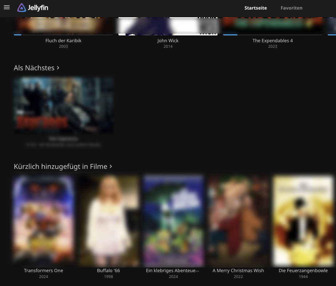

    Hey,
    since the latest Update Media that is copied to my Library is not popping up in the "Recently added" Section of the Start Page of jellyfin Web. This was working fine prior to the 10.10.3 Update. The Media gets otherwise added and detected normally and when i do not forget that i added it and search for it i will find it. But i need to have it in that list...
    How do i fix that?
    regards
    T

    Hm they have not been recent. But when i remove them, touch them so the date is recent and add them back, they will not show up in recently added. And if I change the setting to scan date (makes more sense in my eyes) new stuff will not show up there as well.
