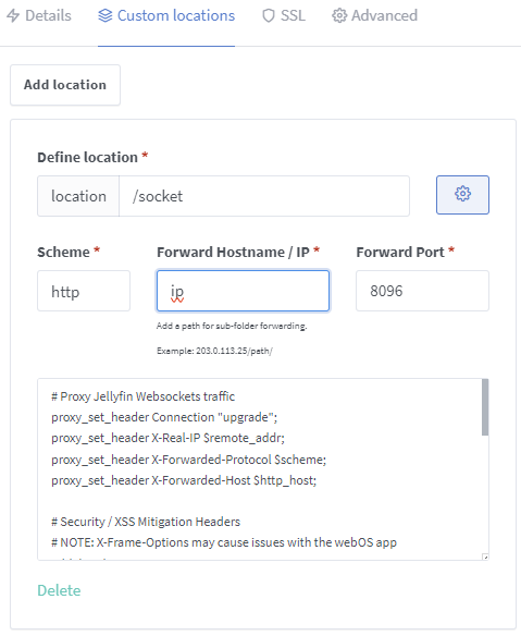

    i have added the custom location like in the screenshot below - the proxy host immediately turns from green (online) to red (offline)
    no matter if i add "/" or "/socket"
    - what am i doing wrong in adding the locations?
    - are those custom locations actually needed?
    - what are they needed for?
    (if it matters, i only use npm for "nice" fqdn's within my lan, no wan exposure)

    Along the same line of thinking as Niel, did you completely copy and paste that section from the guide? Both for / and /socket? First, remove "LOCATION: /" and "LOCATION: /socket"
    Click on "Add location" named /socket and copy the appropriate section from our doc.

    i've added "/socket" and only copied the rest of the code block in there...but still the proxy client changes to red/offline
    should the code block actually go into the custom location config or should it go into "advanced"?

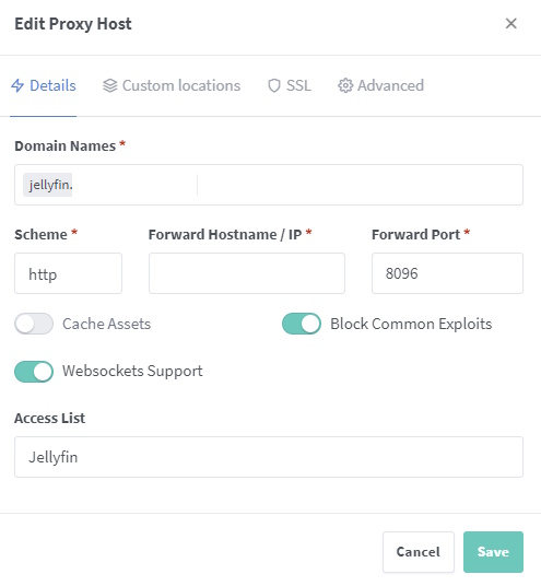

    Can you show us the Details page? Censor the domain. Also, your LAN IP is not sensitive so you don't need to censor that.

    detail site is attached - but i don't think that i messed up there, as using jellyfin and streaming a movie worked

    when posting the individual code blocks (as per the linked guide) into the configuration for the custom location (in the "custom location" tab), i get the offline client
    so the furthest i've come:
    - posting official config into custom location tab -> offline proxy client
