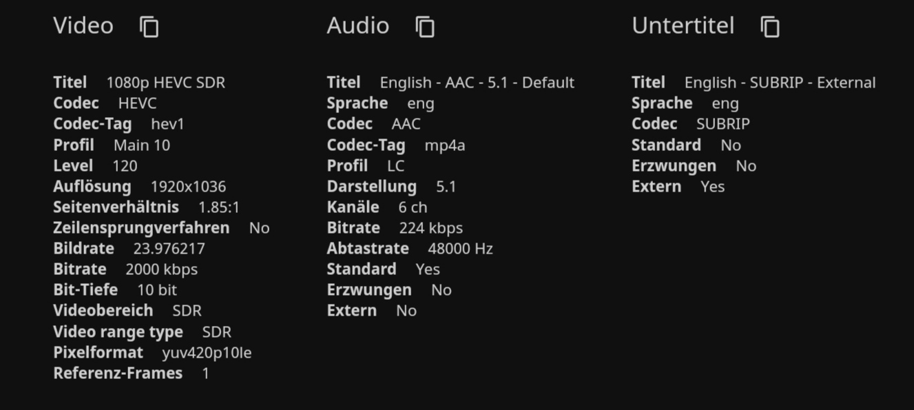

    Can you upload your ffmpeg log to sourcebin and link it back here? And a screenshot of your transcode settings in Jellyfin and the media info the one of the videos.

    (2023-10-05, 05:42 PM)TheDreadPirate Wrote: Can you upload your ffmpeg log to sourcebin and link it back here?  And a screenshot of your transcode settings in Jellyfin and the media info the one of the videos.
    Transcoding settings and mediainfo of a movie
