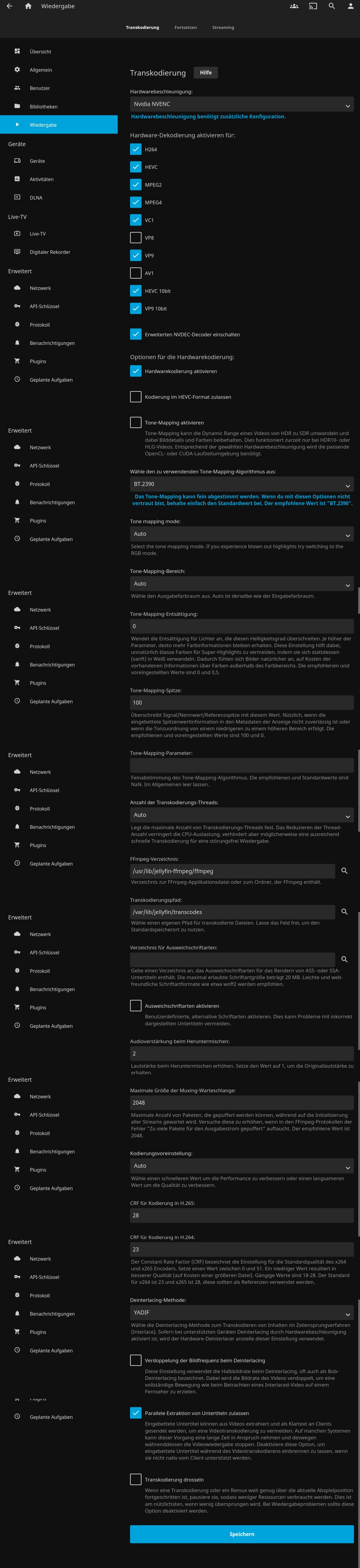

    Can you upload your ffmpeg log to sourcebin and link it back here? And a screenshot of your transcode settings in Jellyfin and the media info the one of the videos.
    Woelfchen
    Posts: 14
    Joined: 2023 Oct
    Country:Austria
    2023-10-05, 05:59 PM
    (2023-10-05, 05:42 PM)TheDreadPirate Wrote: Can you upload your ffmpeg log to sourcebin and link it back here?  And a screenshot of your transcode settings in Jellyfin and the media info the one of the videos.
    Transcoding settings and mediainfo of a movie
    Woelfchen
    Posts: 14
    Joined: 2023 Oct
    Country:Austria
    2023-10-05, 06:06 PM
    Where are the ffmpeg logs located? I'm not a linux expert ;-)
