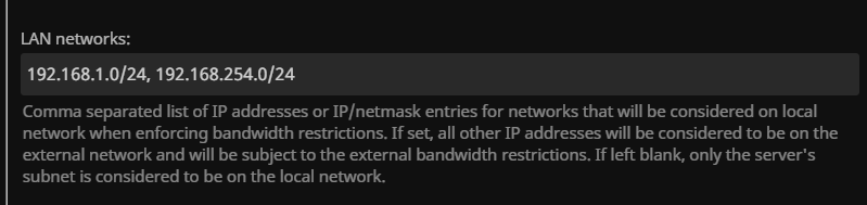

    Reputation: 460
    2023-10-09, 04:59 PM
    (2023-10-09, 04:48 PM)pmarmorris Wrote: OK. I installed Jellyfin onto my Widows 11 machine. I assume that's where the server is. Am I missing something?
    To figure out your IP press the windows button + R.  Type in "cmd".  This brings up the command prompt.  Type "ipconfig", press enter.  The "IPv4 Address" field is what you want.
    (2023-10-09, 04:49 PM)000 Wrote: 'remote connections' in this instance refers to any machine that is not the server
    if unchecked only the server itself would be able to access jellyfin (localhost/127.0.0.1)
    Actually, remote connections refers to all connections that are not in the configured "LAN Networks" field.
