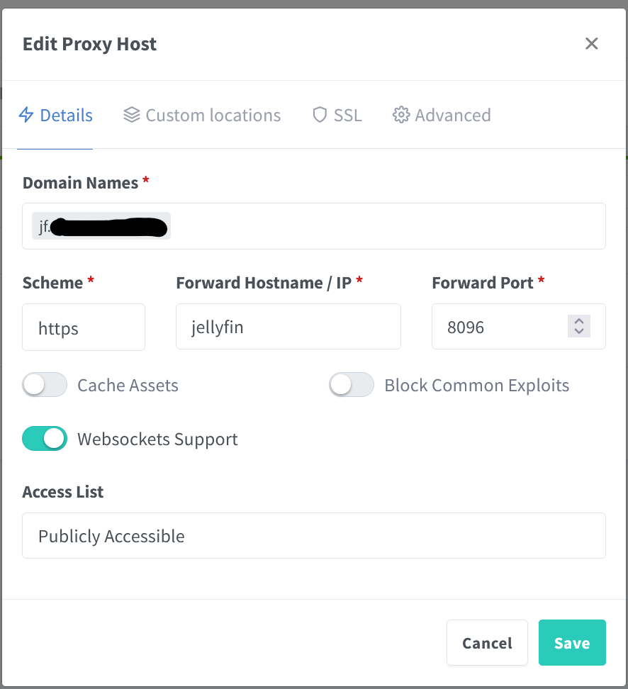

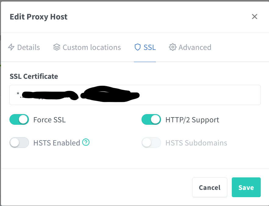

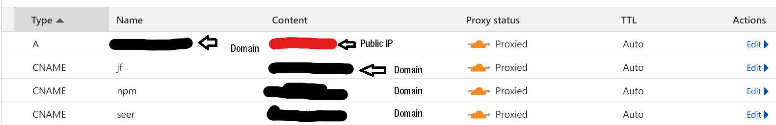

    Hey there,
    Been trying to get Nginx Proxy Manager, along with a custom domain managed in Cloudflare, Jellyfin, JSeer and the *arrs to work nicely.
    So far I've had no success.
    Here's my setup:
    Cloudflare DNS records
    NPM Proxy host setup for JF
    JF Proxy host SSL settings
    JS Proxy host setup
    Properly Activated Cert with LetsEcrypt
    Forwarded port on my Router
    I've also attached my Docker compose file.
    I also am unsure if I'm supposed to forward port 80 on my router, and if that's the case, my ISP blocks port 80, so if that's causing issues, how do I go about that?
    Finally, "Allow remote connections to this server" is activated on JF, but none of the services are accessible.

    2024-02-11, 03:43 AM (This post was last modified: 2024-02-11, 03:44 AM by TheDreadPirate. Edited 2 times in total.)
    1) Turn off proxying in CF. Streaming video through a CF tunnel/proxy is against their TOS
    2) On your ROUTER port forwarding rules, change the external port to some port other than 443/80. But the internal port can stay 443/80. Save
    3) In your browser tack on the new port to the URL.
    I am pretty sure there is a way to get NPM to listen on a different port, but my cursory searches aren't finding a straightforward answer.

    2024-02-11, 04:14 AM
    In NPM, instead of using the hostnames for your services, put in the IP.
    sunnythe14
    Posts: 13
    2024-02-11, 04:21 AM
    (2024-02-11, 04:14 AM)TheDreadPirate Wrote: In NPM, instead of using the hostnames for your services, put in the IP.
    By doing so, now i get
    error SSL_ERROR_RX_RECORD_TOO_LONG with port 5555 at end of url
    bad gateway 502 with port 5556 at end of url
    2024-02-11, 04:25 AM
    Where did you put the IP? I meant in the "Forward Hostname/IP" put the LAN IP for jellyfin.
