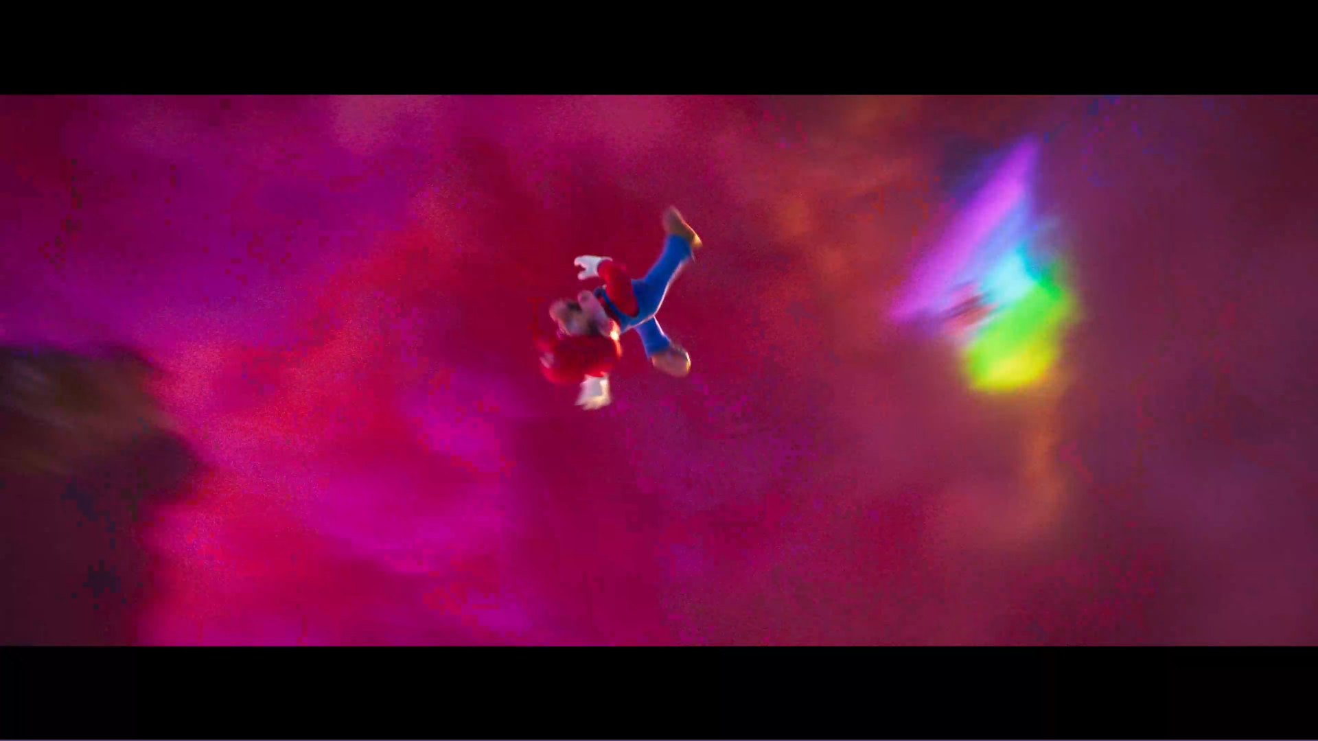

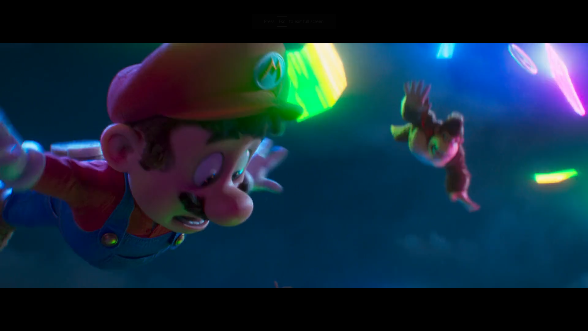

    I'm a newbie when it comes to high quality video playback, graphics settings and the like.
    I'm just trying to figure out why there is pixelating and fuzziness occurring in the some of the color. It's a 4k MKV file (which is about as much as I know about the file), so I figured it should look a bit smoother.
    Is there a setting I should tweak? Is the file just not great quality?
    Attached photos below.

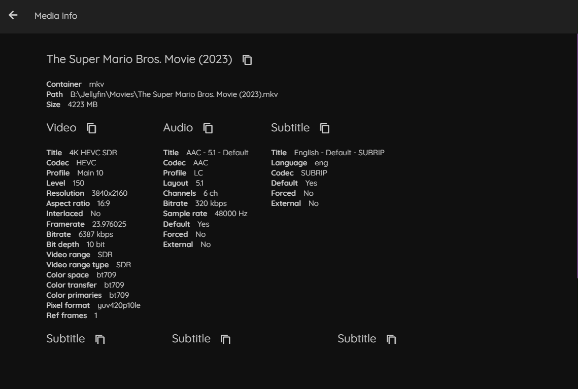

    What's your host OS for the server? Can you run mediainfo or ffprobe and provide the results here? Looking for codec, stream information, etc...

    IMO, that looks like it is transcoding. Either to a really low bit rate or the GPU is older.

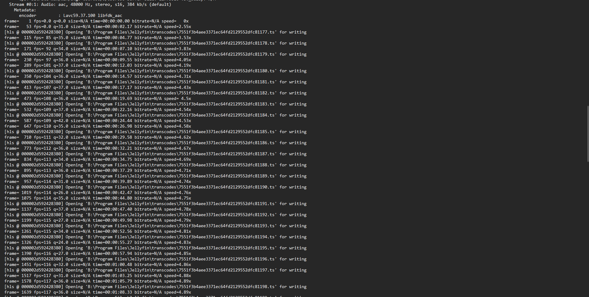

    Looks like the macroblocks is caused by insufficient bitrate. Can you share the FFmpeg.Transcode*.log?

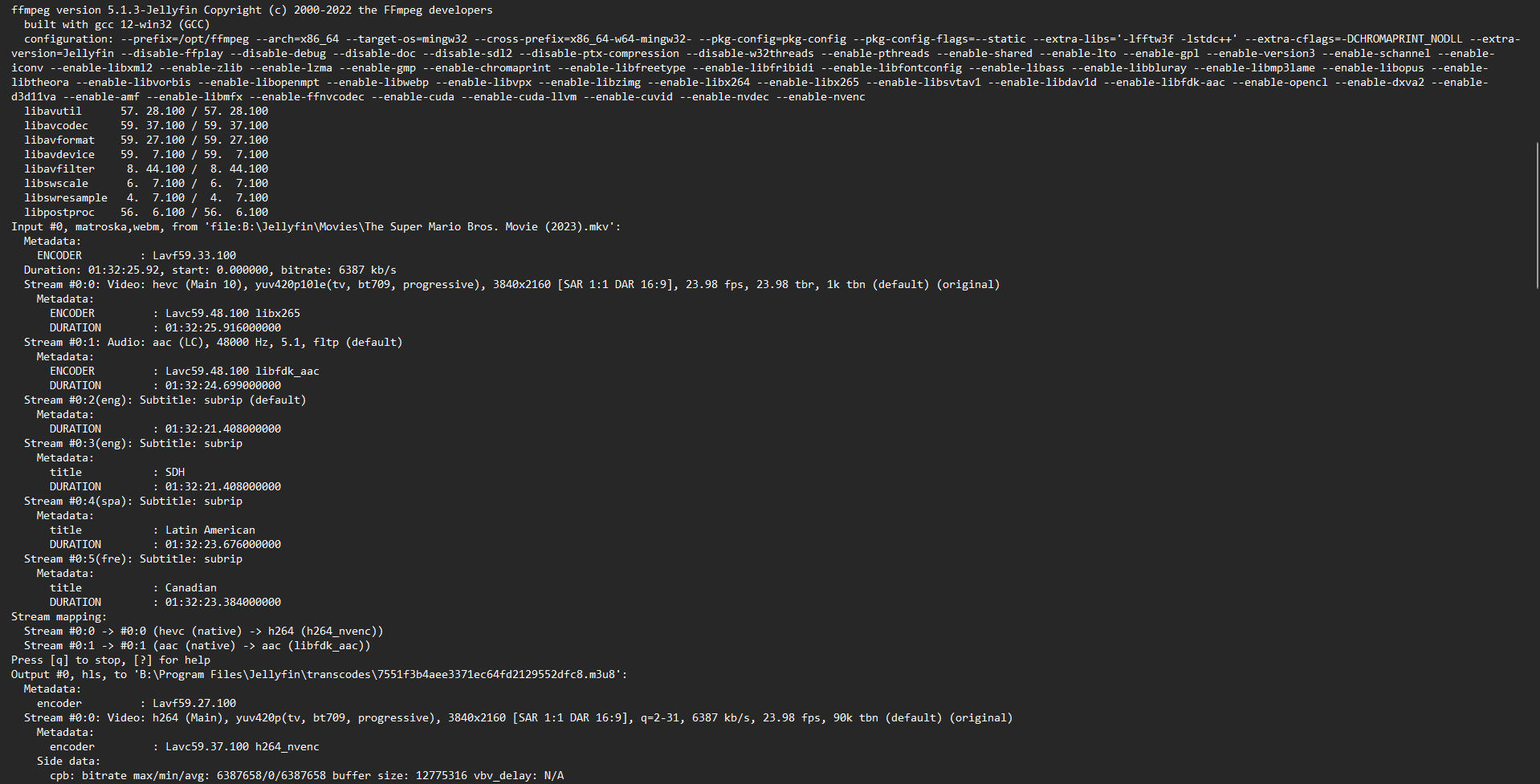

    Here is the media info for the file.

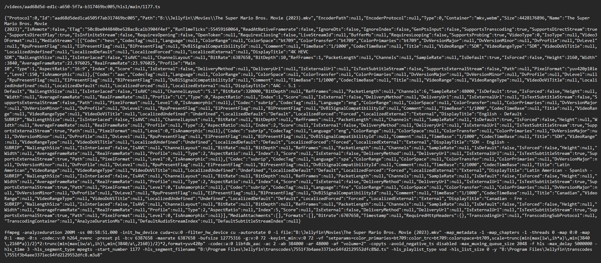

    Here are the logs the appeared when watching back that scene.
    GPU is a GTX 1660 Super. (I know, not an amazing card, but again I thought it should be good enough.)
    As an experiment, I downloaded the 1080p version of the movie and the issue was still present, but at a much less extreme scale. Instead of giant blocks, the picture was just a little more noisy in those areas, which is what I would've expected.

    2023-09-08, 04:14 PM
    The original bitrate 6387 kbps is too low for 4K video.
    Please adjust the encoder preset to medium or even slow.

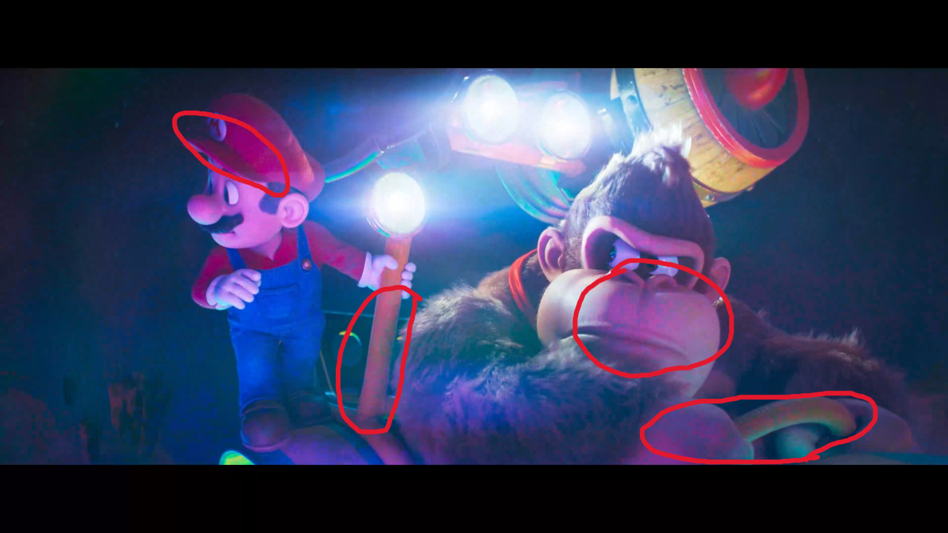

    Tested a couple of different encoding presets but they didn't seem to make a noticeable difference.
    I just took this screenshot while the encoding preset was set to veryslow.
    If you're saying the bitrate is too low for a 4k video, are you saying that the problem lies in the file? Is there a way to ensure you're getting a high bitrate, high resolution download? Or do people typically not upload movies in such a high quality to preserve storage space?
    Thanks again.
    2023-09-08, 05:06 PM
    We generally don't talk about where we get our media. Wherever your are getting yours from used a really low bit rate for the video. 6387Kbps is appropriate for 1080P video but waaaaaay too low for 4K.
