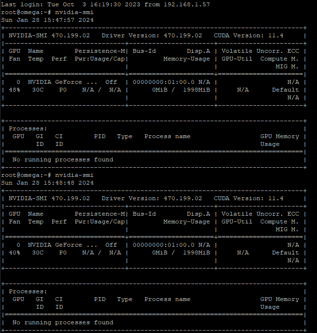

    I am not sure how else to check the nvidia settings but attached is an image I pulled via SSH (jellyfin nvidia).

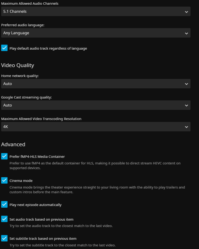

    And attached are my Jellyfin app settings (jellyfin settings).
    My ffmpeg log is also attached. I appreciate the help but I am starting to think this is a driver issue perhaps.

    Your GPU driver version is pretty old. I wonder if the nvidia container toolkit updated and no longer supports such an old driver.
    A specific GPU model is needed. The nvidia-smi cut off the full model name. As long as the GPU is Pascal (1000 series) and newer, update your GPU drivers. 470 is super old.

    Thanks for the reply. I believe my GPU is a GTX 650 Ti. What is the best driver package I should be using and what's the best command to accomplish this from SSH terminal. Anything I have tried doesn't let me change the driver version.
    2024-01-29, 04:46 AM
    A 650 is more than two generations old. Like 7 generations old. I wonder the nvidia container toolkit got updated and depreciated your driver version.
