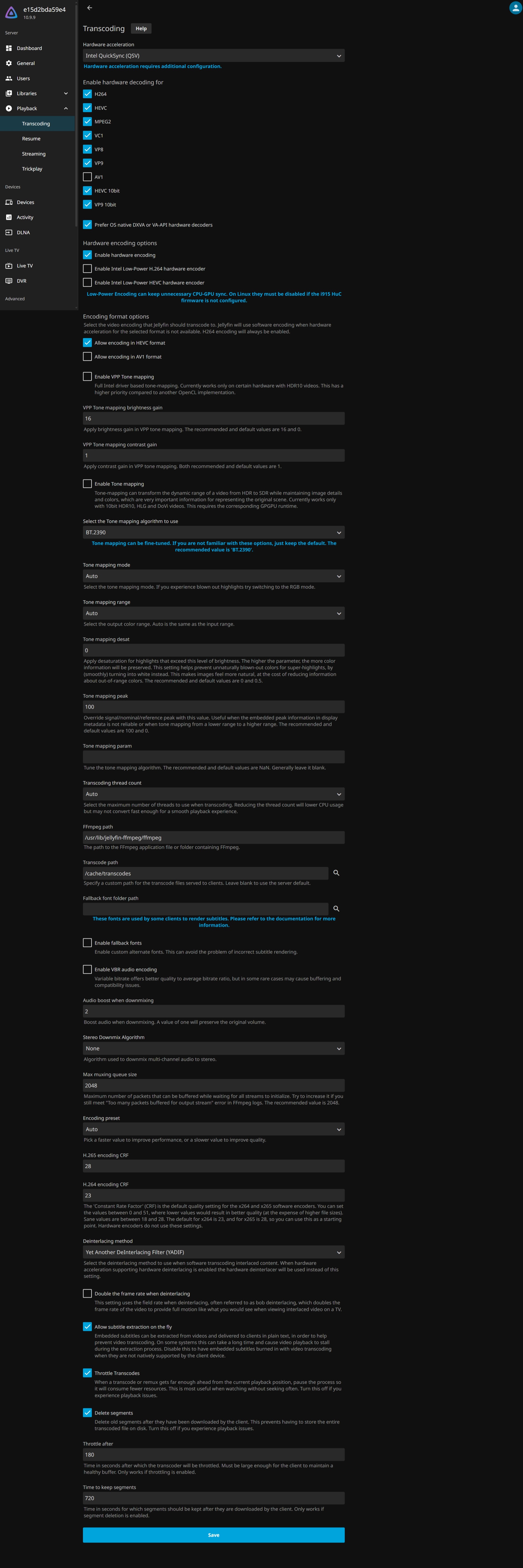

    Share screenshots of how you currently have Dashboard > Playback setup.

    (2024-08-21, 05:02 PM)TheDreadPirate Wrote: Share screenshots of how you currently have Dashboard > Playback setup.
    Sure thing. Attached.
